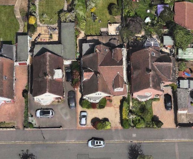

I have recently had my plans rejected with the reason given that my side extention would be an infringement of the 45degree right to light from a study window in my neighbours property. My neighbours have not rejected the application and their window is mostly blocked by some large bushes which are on my property so about a meter from the property. The frustration is that my neighbours have to under aken the same development and have somehow been approved although they have had to inset the 1st floor by a meter, but even so this would still be an infringement of the 45 degree rule for their neighbour.
So my question is that whilst I understand this is council policy, is there anyway to overcome the issue if I have the backing and support of my neighbours. Effectively if my neighbours waive their right to light is it possible to get my plans approved under appeal.

Can you post a site plan showing the relationship between the two properties and the road, with the widow and 45° line marked.
Remove any identifying text.

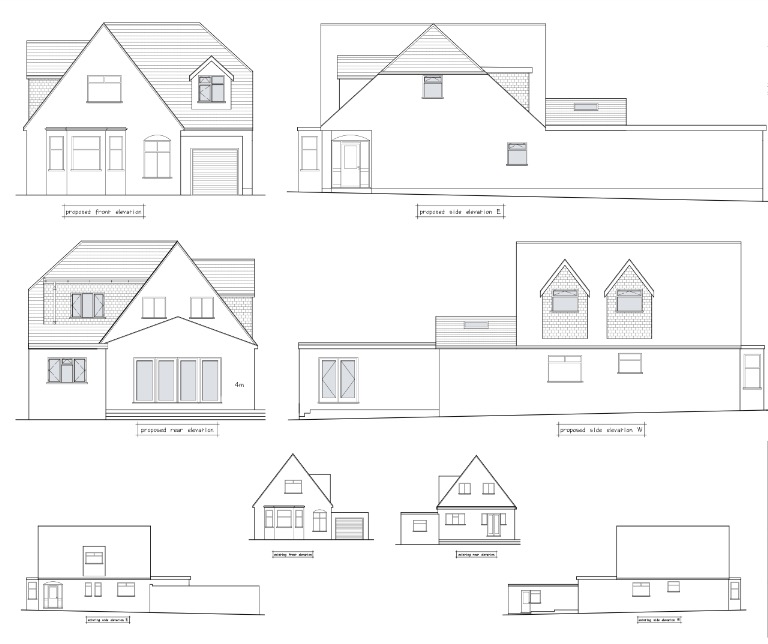

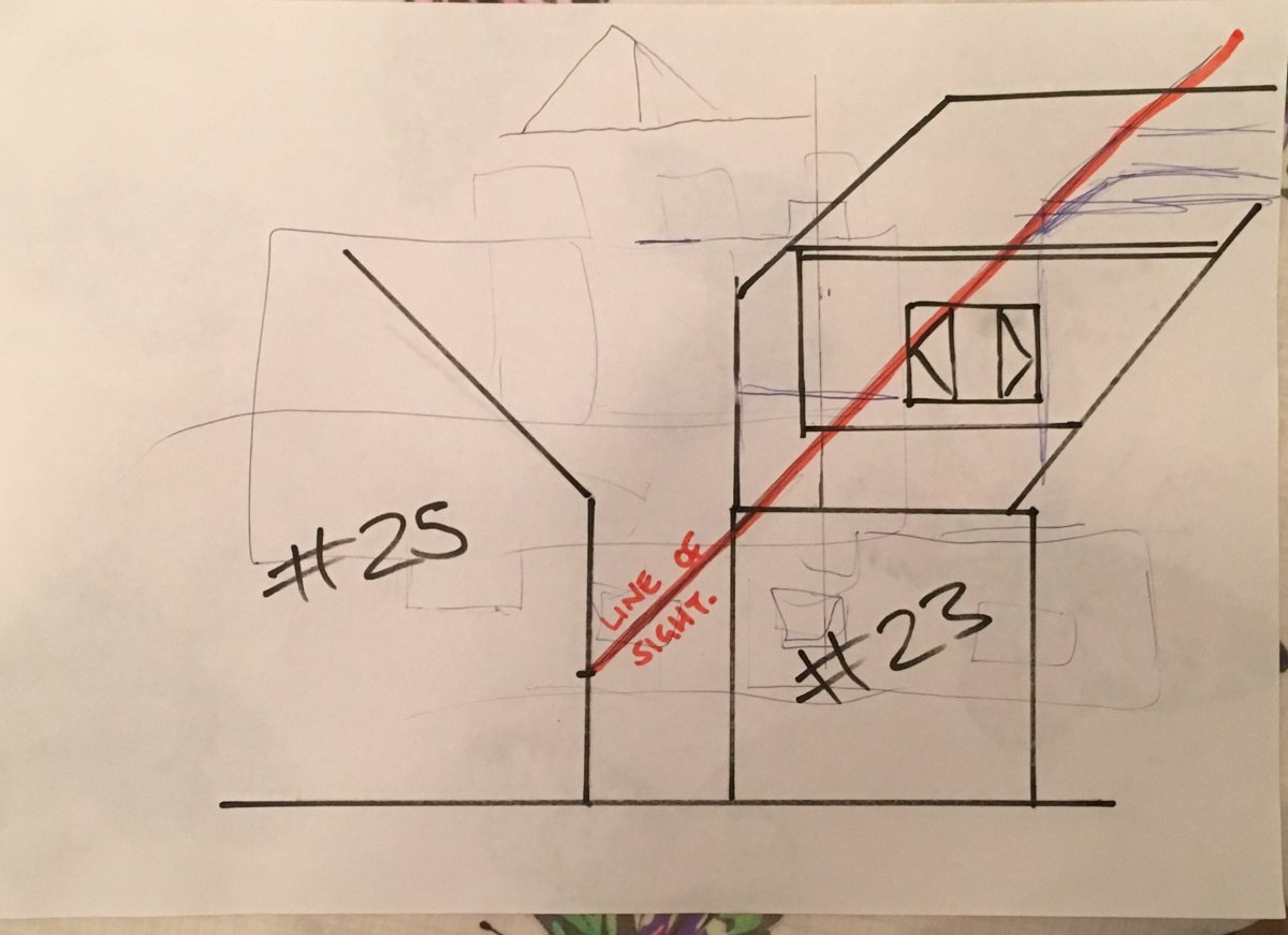

Thanks for your comments everyone. My house is the one on the left in the photo but #23 on the drawing looking from the rear. What I was trying to do was replicate the house in the middle . There is a study window on the ground floor just behind the dormer which is preventing my plans going though. Somehow my neighbours have been able build although they had to step the 1st floor by a meter. I am waiting for the planning officer to respond to my request to do a similar thing but I am dubious . You can from the next picture the line of sight would still be an issue.

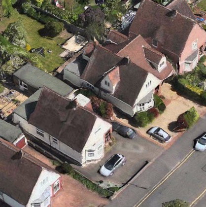

I assume the neighbour's study window is the 3 pane window towards the rear of the building seen from the birds eye view photo. In which case it looks like this is a room which has been enclosed by an extension so originally that room might have had a second window to the rear elevation. Either way I doubt the study is an original use of the room and it was not originally a habitable room with only 1 window on the side elevation. Your house appears to have the same situation with a rear flat roof extension and 2 windows on the side elevation.
It seems unfair if the neighbour has undertaken alterations that has created a new room that relies entirely on your driveway remaining clear to get any daylight.
I do not know the planning rules on this but I would have thought you could put forward an argument that later modifications to the neighbours property have effectively meant you cannot have a side extension, possibly not even a single storey one, which is inequitable especially as the neighbour has built a large side extension on the other side. Especially when it looks like the new roof slope will be quite low near the rear eaves where the offending window is.
