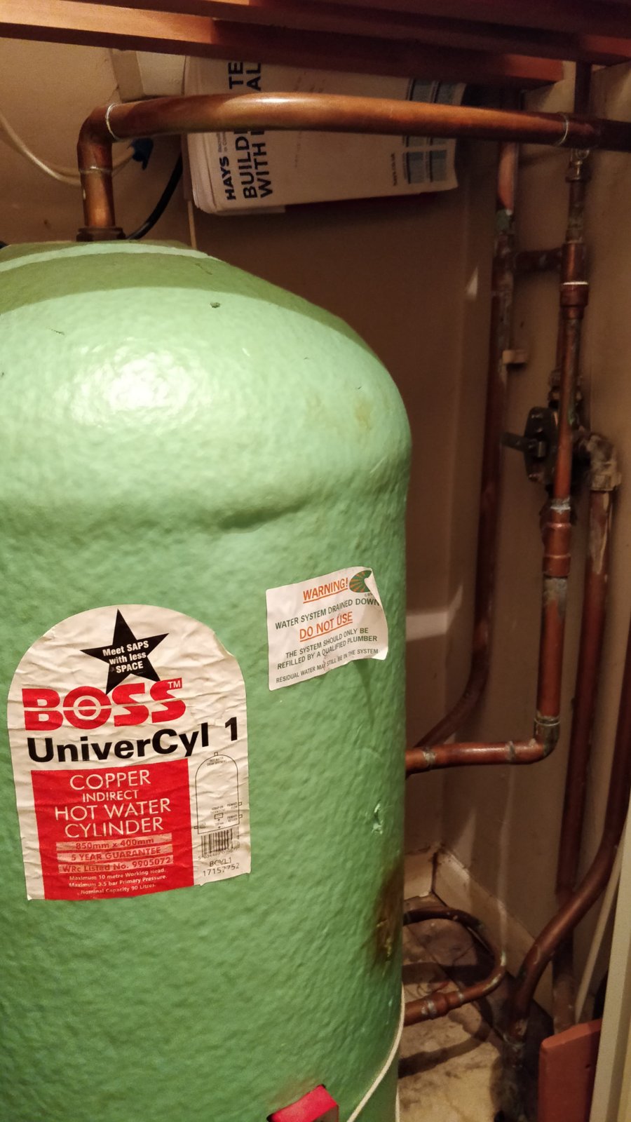

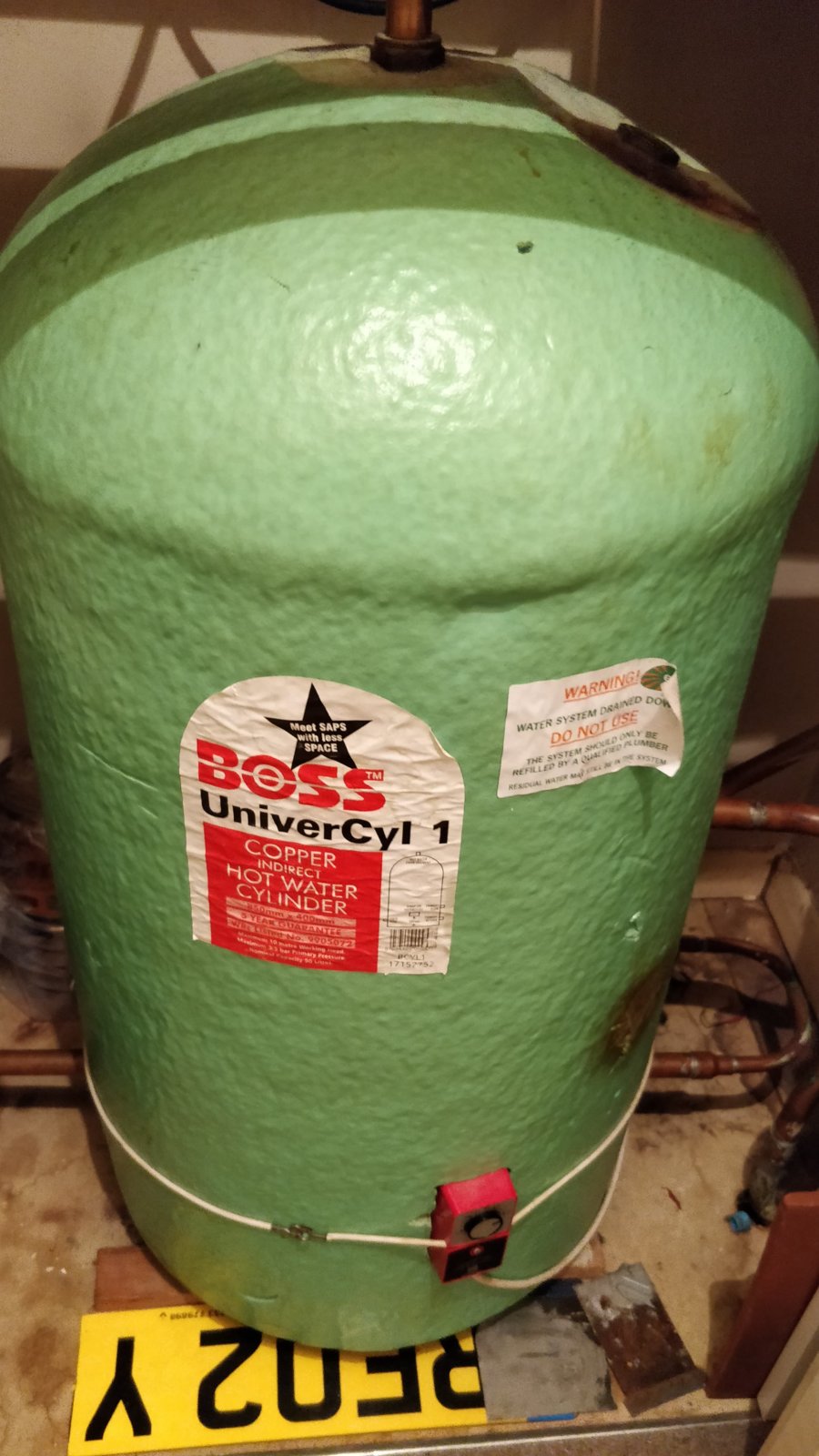

What colour is the cylinder?
OK. I thought it was an immersion heater, but the plumber said it isn't. He said it's just a storage tank. The tank is like a yellowish sort of colour. I think its a normal copper tank with a coating over it. I really don't like the thought of outside pipework - to me it would look scruffy.
I want my tenants to have access to decent hot water and I thought as I was being told to change over to a combi that would be the best solution - I just thought combi's was the way to go in this day and age. I think I'd rather have the same sort of boiler if necessary and fit an electric shower so that my tenants always have a back up option if the boiler breaks down.

OK - I'm colour blind - its green.
So, is it OK to simply swap it for exactly the same boiler - a baxi solo 2. Or do I have other options that don't involve external pipework. What would be best for the tenant please?
You or the previous owner have had problems at the cold feed by the look of things and the head of the mid position valve is missing, looks like a Drayton. Is the shower electric?

The shower over the bath runs off of the storage tank. Its not an electric shower.
I have owned the house for 7 years and not had a problem with the boiler or tank previously. Why do you think there has been a problem with the cold feed? Can the head of the mid position valve be easily replaced?
