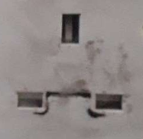

Finally... Do I potentially need to be concerned about that one socket? The previous owner had a fondness for plug in smelly things which seems to have discoloured a lot of the sockets, though none quite like that. Until I get it properly looked at, I'm not using it, though I am using the one next to it (and, after use, it didn't feel at all hot, if that makes a difference).

Any sockets or switches that show signs of overheating (like in your pic) are not safe and MUST be replaced with new. New sockets are not expensive but you need electrical competence to fit them.

Not really worried about the black marks on the USB socket. Could be from what was plugged in.
To my eye, it looks not just soot-stained, but distorted from heat as well.
Perhaps I am wrong.
Ptork?
To my eye, it looks not just soot-stained, but distorted from heat as well. Perhaps I am wrong.
I don't know about 'distorted', but I would certainly want to give it a proper eyeballing to find out what is going on. It could, of course, be that most of it will just 'wipe off'. If it's not an optical illusion, perhaps the most 'suspicious'/concerning thing is the apparent blackening on the L-pin shutter.

It doesn't wipe off. I'm fairly certain the previous people had their washing machine plugged in to it. If one of a double socket is likely dodgy, should I also stop using the fine looking one until I've checked it out? I need to do some reading on how double sockets work.
Without taking it apart for inspection, nobody knows. But if the marks don't rub off, or if there is any sign of charring or heat distortion, you should not use it, and should replace it at the earliest opportunity. UK switches and sockets are made of a plastic which is fairly heat resistant, and does not soften, melt or easily burn, but it will char, crack, and become brittle if overheated, so can break later, for example when pulling a plug out.
washing machines have a heavy load during the heating cycle, but tumble driers are worse as it continues for longer. A BS socket should be capable of carrying a 13A load indefinitely, but some are better than others. I don't know what make that socket is. As it has USB chargers it was most likely a DIY fit and might have had loose connections or been bought on a market stall.
BTW a double socket is not required to have capacity for two 13A loads at the same time. A common cause of failure is a washing machine and a drier plugged into the same double. This frequently leads to overheating damage.
I tend to run my washer on colder cycles, if that makes a difference, and don't have a tumble drier. And, yes, there is some suspect DIY plumbing, so I also wouldn't be surprised if that socket was shoddy DIY, too. Since the plug is used for a washer, I wish it wasn't a double at all, but I'll settle for one that isn't possibly unsafe and just not use the second. It seems like it'd be a bit more work to change it back to a single.
RE double sockets: I was just thinking that if they don't share the same wires, then using the non-burnt one might be okay. But from the very brief search I did, it looks like they share wires? But I don't think I'll risk it either way.
