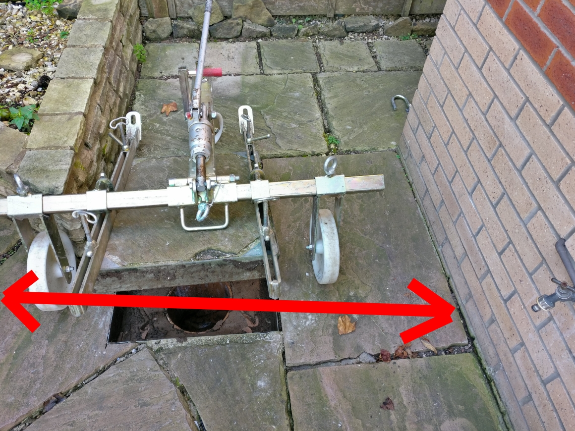

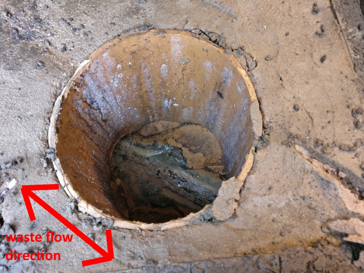

Today i managed to get the cover lifted up and turns out its just an inspection chamber and only flows in 1 direction (not sure which direction yet though). Have taken some pics while i had it up.
Is it good news for me that it is just an inspection chamber and not an actual manhole as i can only assume that having this relocated should be way more easier than having to construct a new manhole?
Ah right ok that makes sense and its flowing from my kitchen to the outside, but if R-L then it would seem to suggest that it is flowing towards my back yard? i would have assumed that it would flow towards the main road which is the opposite direction (front of my house). obviously i know nothing about drainage but is it a good thing for me if it is flowing this direction?

Thanks for your advice, i can see what you mean by the laterals. Im going to pour some water down there to see if they are in use or not because from the angle that i looked down it seemed as though it was blanked off.
I cant actually 'move' the cover away from the hole location ifself due to a brick wall being in my way, the best i can do is hoist it up and take some pics from a distance as i didnt want to stick my arms under a 50kg floating weight haha
Might just get some rods and poke around to see if it really is just flowing in 1 direction

The direction of the run is R to L (in your first photo) - get somebody to flush WCs, run basins and sinks in sequence while you watch the chamber so that you can find out what connections you have.
Laterals are always angled into direction of flow, so flow is definitely from R-L, (unless by some miracle the drain layer put it in the wrong way round. (And nothing would surprise me....) This will probably join onto a drain run across the rear gardens, communing a number of homes on the same run, until eventually joining into the main sewer under the road. From the point that run joins with the run from one or more other properties, or passes under your boundary, it becomes UU's responsibility, so maybe worth checking how much further it goes.
Looks to me like both laterals are blanked off, it's been (sensibly) put in to allow access to the run if ever required. Good news is, hopefully it will be fairly easy to move, provided the run continues in a straight line to a point outside the footprint of your proposed extension, and there is room before it hits the main run, it is fairly straightforward to simply remove the chamber from that point and bridge the gap with a section of pipe, then either relocate the chamber further downstream, or install a chamber on the junction where your run joins the main sewer outside the proposed extension.
