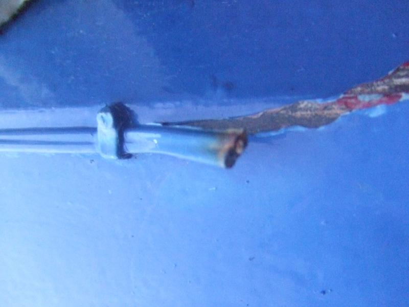

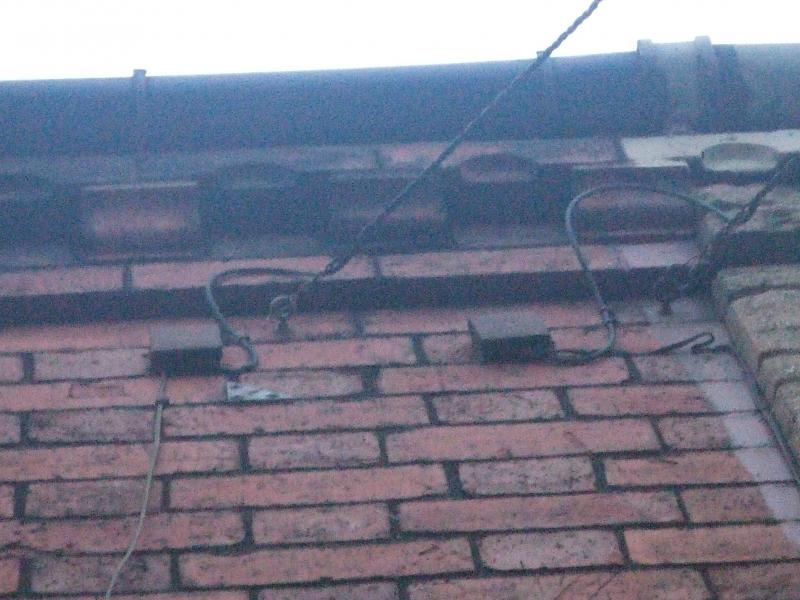

It may have been misunderstood what cable I mean so I have posted a couple of photos. The cable I need to replace comes from the box on the left in the photo and looks like bell wire, it didnt have any steel in it when i cut it. Intend to replace with black 6CW telephone wire.
ok there is already a BT junction box on the outside of your property, that makes life a lot easier. Get some outdoor grade telephone cable. Try and find some with a reasonable pair count (2 or 3 is probablly ideal, 5 is probablly on the edge of what you could get away with) so it doesn't look too suspicious. BT dropwire would be ideal but if you can't find some scrap BT dropwire something like http://www.tlc-direct.co.uk/Main_Index/Cable_Index/Telephone_Cable_External/index.html would probablly do.
Whatever cable you buy you will probablly find it contains pairs that are loosely twisted make sure you use the two wires from such a pair.
there are only two cores, in the existing cable so that makes life easy. look at which wires they connect to in the incoming cable and join your new wires to the incoming wires using either the terminals in the junction box (if they appear to be in good condition) or jellies (if they don't).
at the master socket end connect the two wires to the A and B terminals. ideally the positive wire should be connected to A and the negative wire to B (an active phone line always has a voltage on it) but most equipment doesn't care (and if the line is currently dead you won't be able to find out which is which).

As I read it, there is a BT junction box present, so cable will feed from here. Outdoor grade telephone cable, as suggested above
