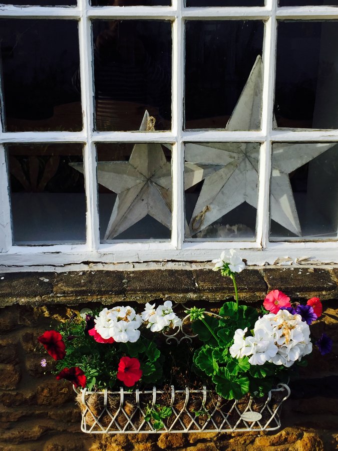

Hi,
I used to live in a new house with UPVC windows but now live in an old house with wooden casement windows. Some of them are rotting on the sills so I am trying to figure out the best way to repair these myself. As it is the first time I have undertaken such a task I want to ensure I know the best way. I have attached a picture of the worst window below.
I found a youtube clip:
It seemed informative but was in relation to a larger repair and the guy did it with car body filler, then painted over with water based paint. What I want to know if anyone can help is:
1. Is car body filler better than something like Ronseal High Performance Wood Filler ?
2. What grade of sandpaper is best for gaining a smooth finish? I have a Black & Decker Mouse sander which I can use for that.
3. The youtube clip mentioned about painting directly onto the glass then using a window scraper to remove the pain on the glass. Can this be done with gloss?
4. Any recommendations as to best exterior paint to use?

A photo of your Sill may assist replies?
If the damage was in my house or I was asked to undertake a Car Body Filler Repair, I would walk away. in Sunshine the Coefficient of expansion differential between the remaining timber and the Car body Filler is large, then comes the rain and rain water will enter and continue the rot on the Sill

That frame appears to be well past it's best, I'm afraid but to try and answer your questions......
Ronseal and car body filler are essentially the same, but car stuff is a little easier to mix and as the oxidising agent is usually red in colour, it's easier to see when it's mixed.
Start with an 80 grit paper, and go to a 120 grit to give a smooth finish.
If I didn't have a steady hand, I'd consider using masking tape to prevent paint covering the glass.
Zinsser have quality undercoats that help with a good gloss finish.
John :)
dont bother with car body filler,research resin repair its excellent gear and you can fill large areas just by putting in pieces of timber to take up the space.
Thanks for the replies. The affected area does not appear to require much wood to be removed. It's more of a long crack.
I have just found Unibond Repair Wood for good resin repair so I think I will get some of that. I have checked the reviews and they all say it's very good.

You need a fibreglass paste. Car body filler isn't very waterproof - it actually gets waterlogged over a period of time. The paste is what they use for marine repairs. You can get a 2 lire tin from Halfords for 15 quid. I use it for loads of things around the place.
