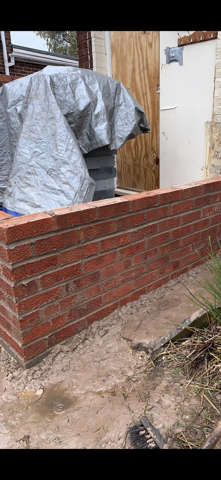

I’m hoping someone could help me out with work I’m having done on the house. I am having a new porch built and the brickwork (I think) is not up to standard. I have raised the issue with the bricky but was told it’s the difference in brick size that is causing problems?
First pic shows the bricks are not straight and I have put a ruler showing this.

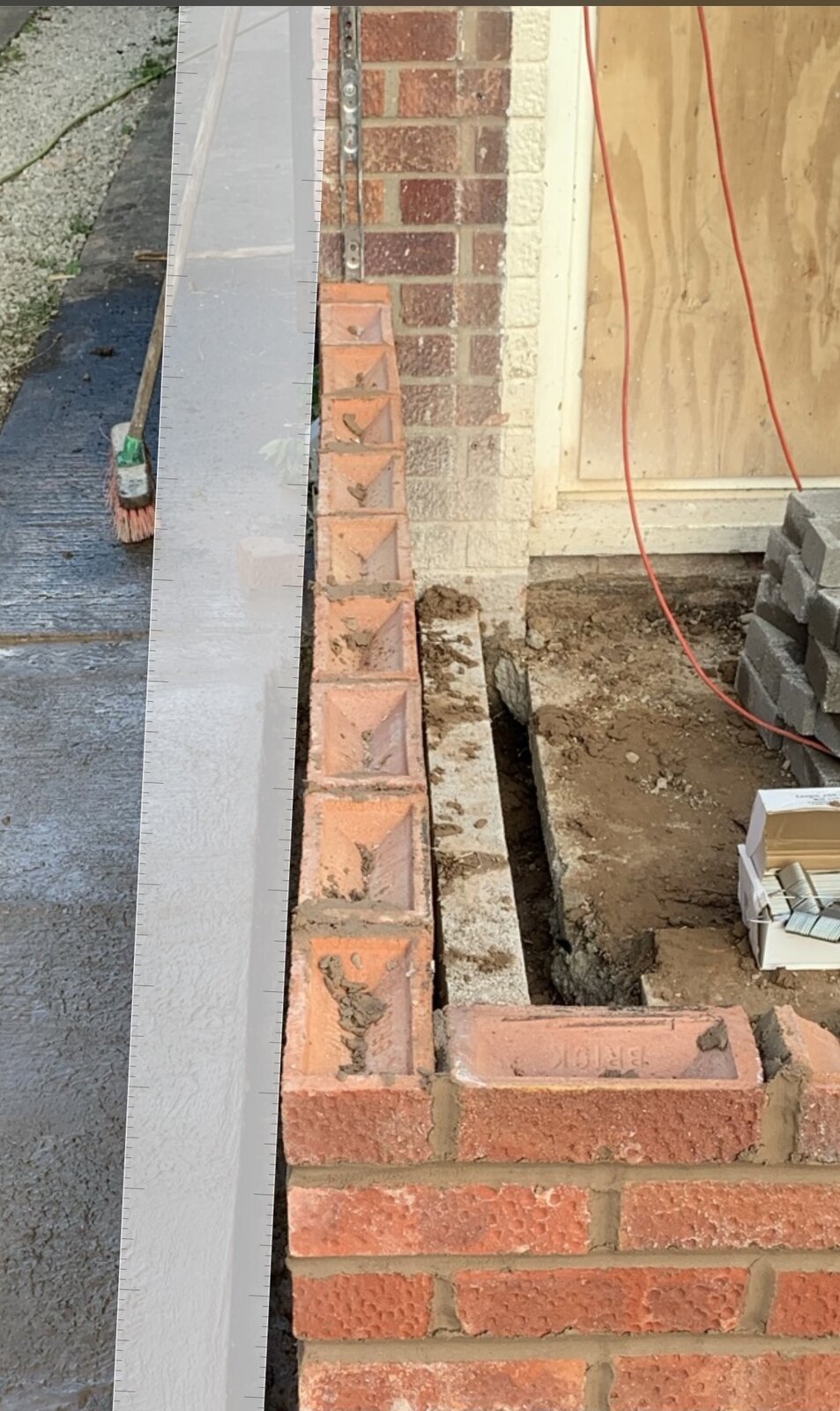

And secondly you can see that the bottom half of the brickwork seems to have fairly consistent gaps between them. Then the top half has very large, untidy gaps in the cement. I’m not a builder so please bear with my terminology. Hopefully you get what I’m trying to get at.
Am I being picky or am I justified in saying it’s a shoddy job?
Thanks for any help.

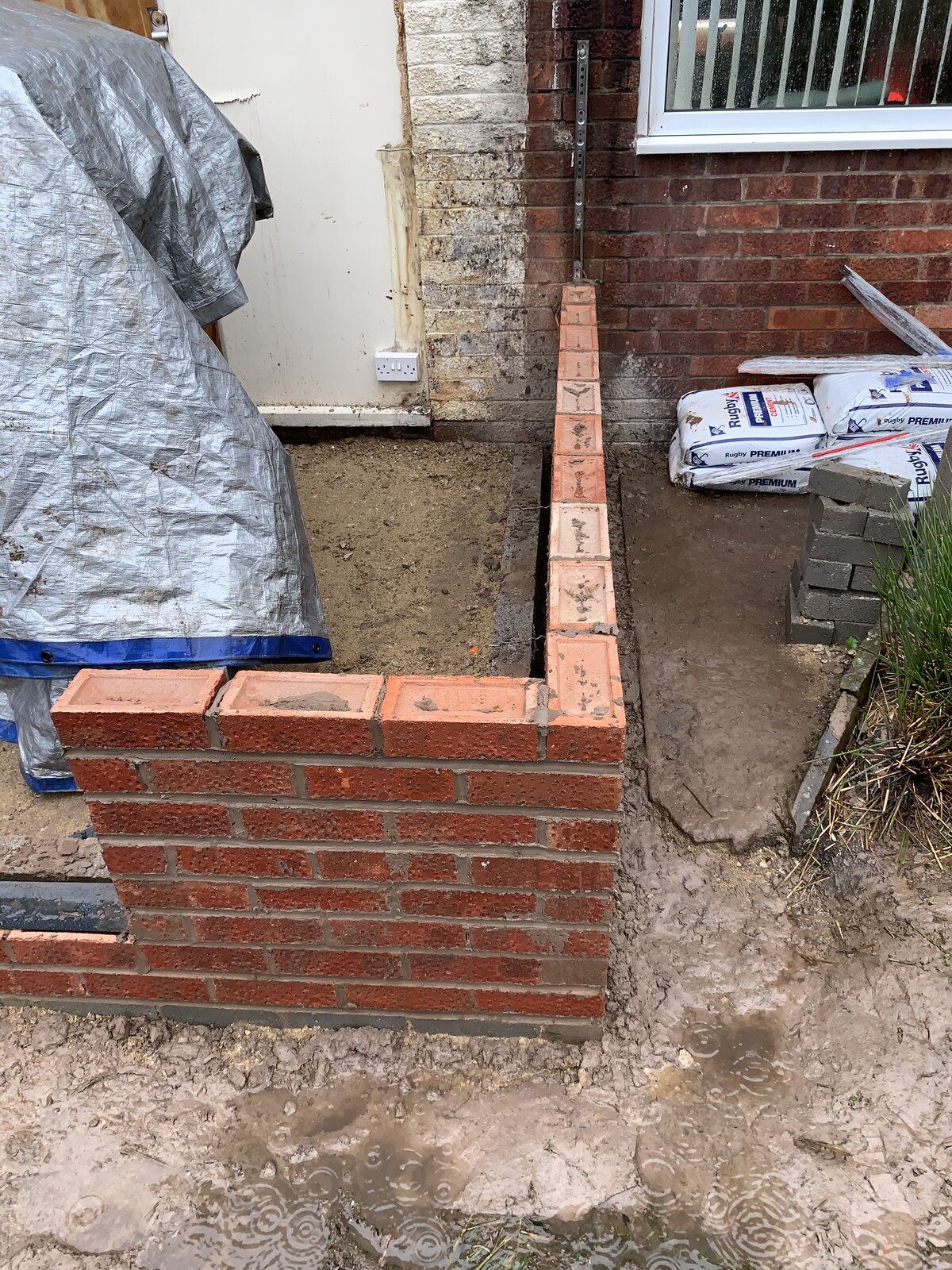

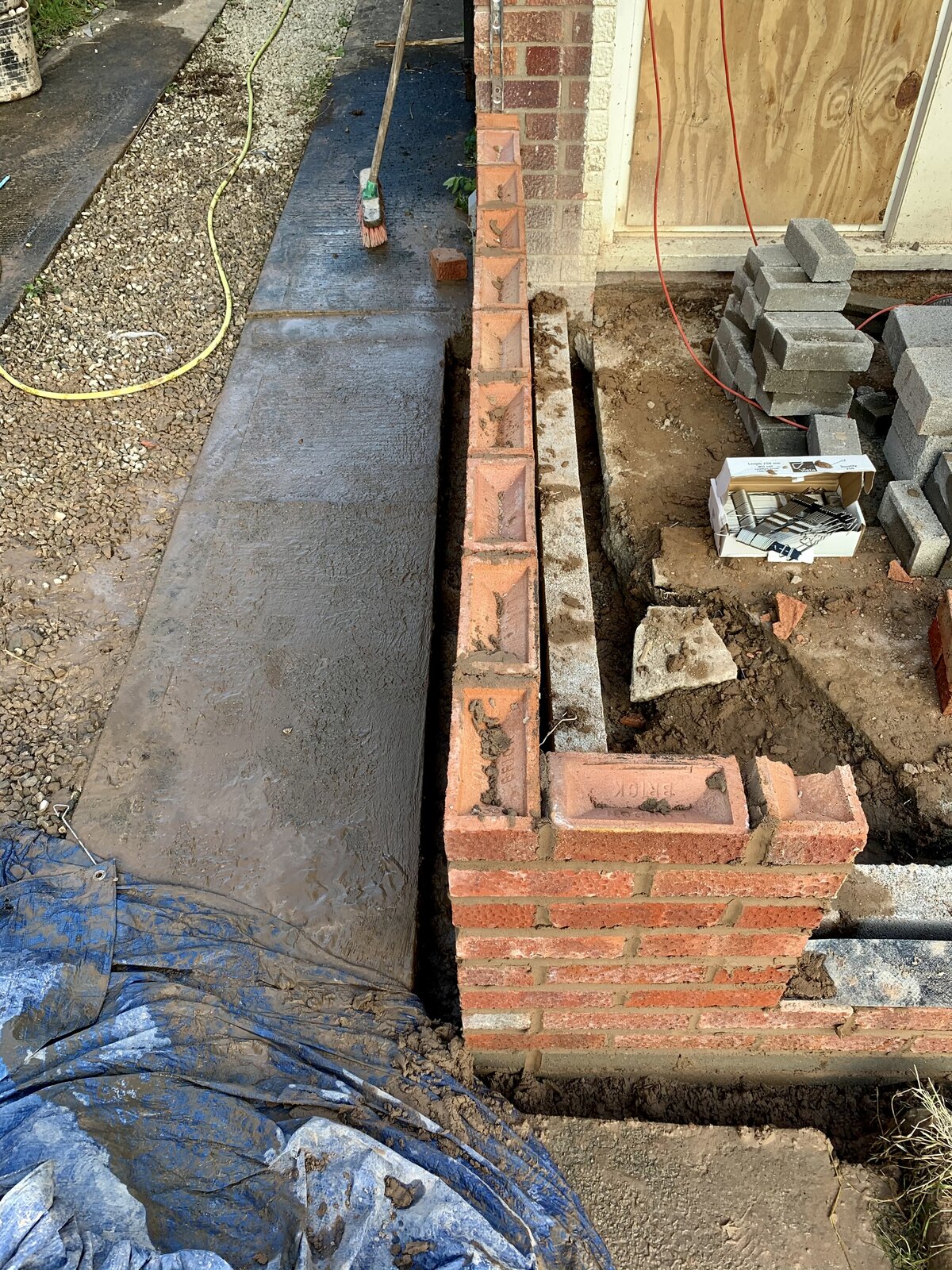

I see an inner leaf, so a double skin wall.
But if he's not going up at the same time and not using ties, how the hell is gonna put them later?

Tell him you're unhappy with the work and to cease working on the job. If he asks for money, say you'll have to pay for the existing work to be demolished.
Tell him to knock it down and clean the bricks.
Not too difficult with fresh mortar.
