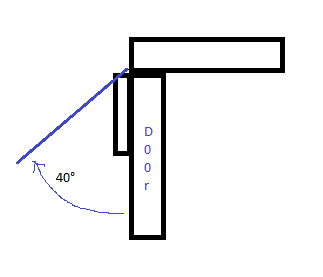

Hi,
Have fitted under stair storage and have managed to incorporate a minor design flaw. The Mrs wanted flush doors with a little border around them which I have done, and fitted inset 110° concealed hinges, but the doors get stuck when half open. I need hinges which open the door outwards before swinging open but not sure which ones to go for (preferably concealed). I have seen these which I think might do the job but can't find a non-trade outlet anywhere which has them https://tinyurl.com/287mrcs8
Cheers
