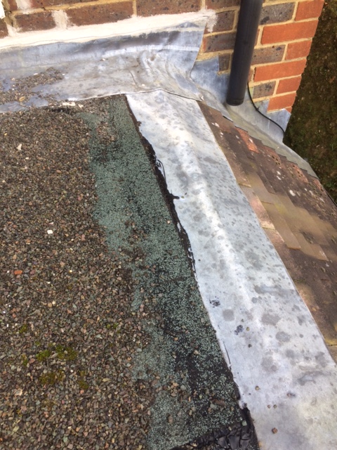

Hello,
My flat roof is felt with small chippings on top and edgings of what I assume is lead (see image atached).
The problem is that there is no restrictive edge and the chippings wash off into the gutter as they are loose laid.
My query is the best way to repair.
Is there a thickish bitumen or similar which I can paint on and add new shingle which would adhere to it and so not get washed away.
Any advise please.
Best Regards.

You report no leaks or water damage below the roofing - surprising considering that all the flashing at the wall abutment (and the change of pitch flashing also) appears to be wrongly fitted?
The chippings should originally have been embedded in bitumen.
Your top sheet, on my dodgy monitor, doesn't appear to be the correct material.
However, brush the chippings up as best you can & re-use, they seem to be loose laid, you can buy fresh bags at building supplier's.
Then spread a liquid bitumen over short manageable areas.
Then embed the stones into the liquid bitumen, use a short block of 2 x 4 to press them down while keep the chipping cover even. Cover all the top sheet.
Leave all the lead flashing bitumen and chipping free.
I'd get I'd get a balloon guard ( down pipe guard ) and put it in running outlet, just pick out the chips from the gutter once a year they wont do any harm. Don't see the point putting money and effort into such a trivial problem

A diyer up there taking chips off could end up bursting the felt when shovelling up the chips, doesn't look in great condition, keep the money you would spend on bitumen and more chips and put it towards getting a new roof with a good quality product in a few years
Why would he be "shovelling" off chips"? Common sense says stiff broom them up - they are loose laid after all, & most will sweep up.
We dont know the area of the roof so with a couple of bags of chips and a few litres of liquid bitumen costing, say, £25 quid I dont see any big outlay.

If you are brushing of all the old chips, dry the roof and give it a couple of coats of solar reflective paint, discard the chippings.
Any builders supplies - cheapest available will be best.
Solar paint would do fine on a nice clear and clean surface - only some chippings and debris might be embedded by now - but its a good suggestion.
Depends as well on how the OP wants his roof to look?
