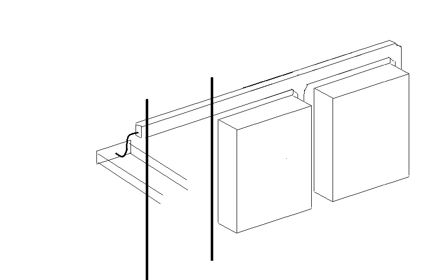

I'm altering stage lighting as part of a refurb and run into a silly little niggly corner.
The 100x50 trunking at the top is at ceiling level, to the right is an office to which I have no access and the other side of the office is the power/dimmer cupboard. Trunking used to continue to the left [red] but has been cut of almost flush with the office wall to make way for the new hole in the wall for cable basket. Originally [red block] this was to have been some 300mm from the ceiling and office wall and my intention was the new SY lighting cables were to come through the hole and straight up, terminating in glands into the trunking [orange].
However the new hole is less than 100mm from the slab and 40mm from the wall with the top of the basket marginally higher than the bottom of the trunking [hole, basket and trunking shown in black].
It's going to be a PITA but I think the cables will loop round into the end of the trunking OK from the hole.
At the dimmer packs there is a large cut out [maybe 150x30mm from memory] between the vertical 50x50mm trunking and side of pack.
My question based on previous discussions is: what are peoples opinions on the best way to terminate the SY cable. At the moment I'm looking at a pigtail into the earth bar once it's inside the pack but I am struggling to find anywhere to provide any mechanical restraint.

These are 18 core 2.5mm² multicores between packs and patchbay.
Your drawing shows 8 cables, what diameter are these 18 core cables.
They are about 20mm diameter but without the outer sheath and screen they're probably down to about 16mm which is far more manageable when the screens are terminated at the trunking. There is plenty of space for 8 but I am not looking forward to pulling them neatly into the 4m run of 100x50 trunking.
The trunking in question is in the ceiling of the office and it has been made quite clear that removing the plasterboard for access is out of the question, until now it has only had 2.5mm singles in it which are far more manageable. I'd have changed it to 100x100 when I had the opportunity if I'd had an inkling of the current situation but I reckon it may be impossible to change now with the sprinkler pipe in situ. Ironically it turns into 100x100 when it gets above the packs.

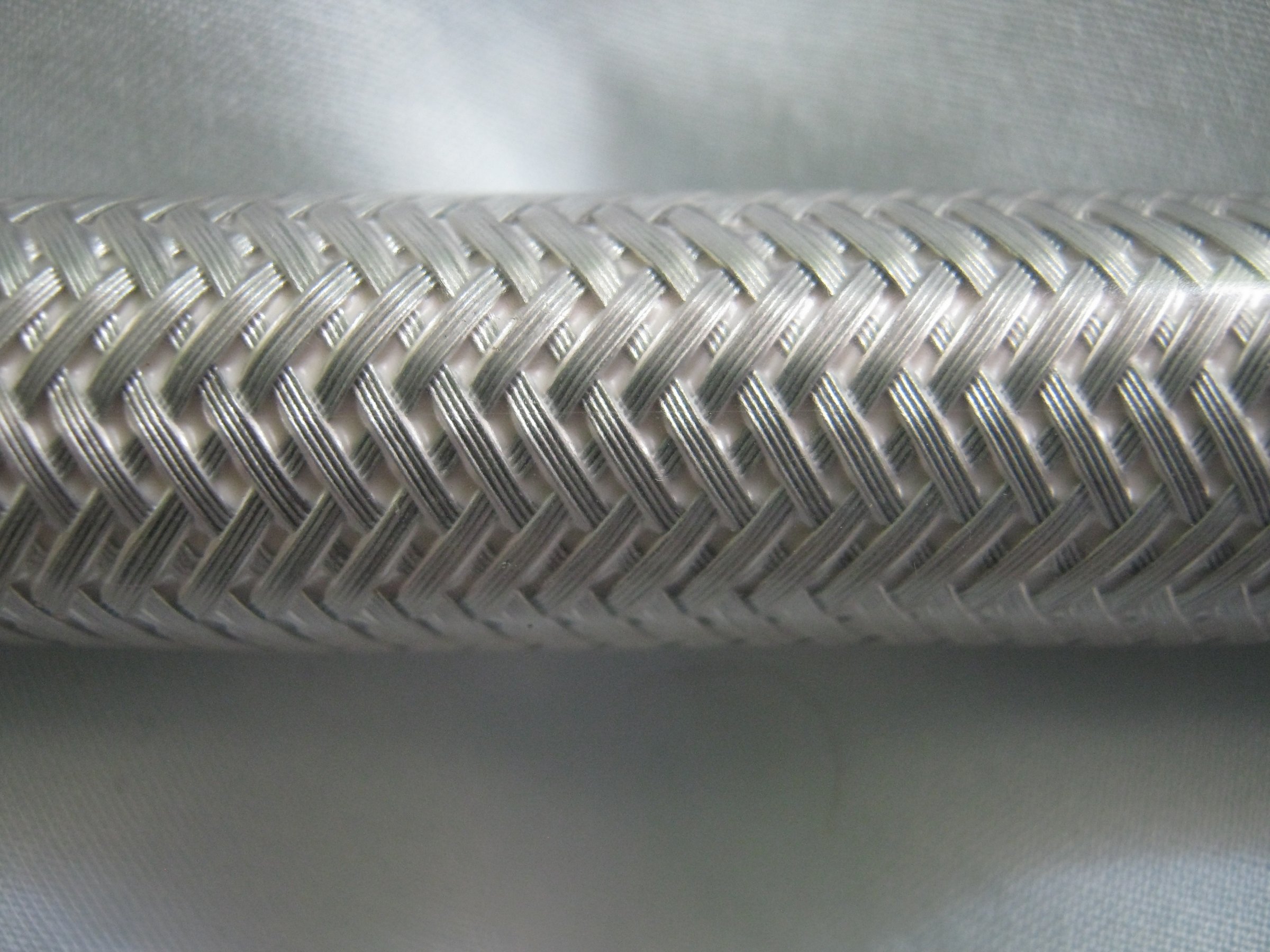

SY is a control cable, and is described as such on all manufacturers data sheets, and offers no screening, the braiding is full of holes.
Clearly visible here - you can see the white insulation through the braid
However. Eland cables state:
"The voltage rating for these shielded flexible multi-core control cables is 300/500V."
and also:
"SY control cables are not suitable for fixed wiring applications requiring compliance with the requirements set out in BS7671."
so it seems there is some confusion around!
and also:
