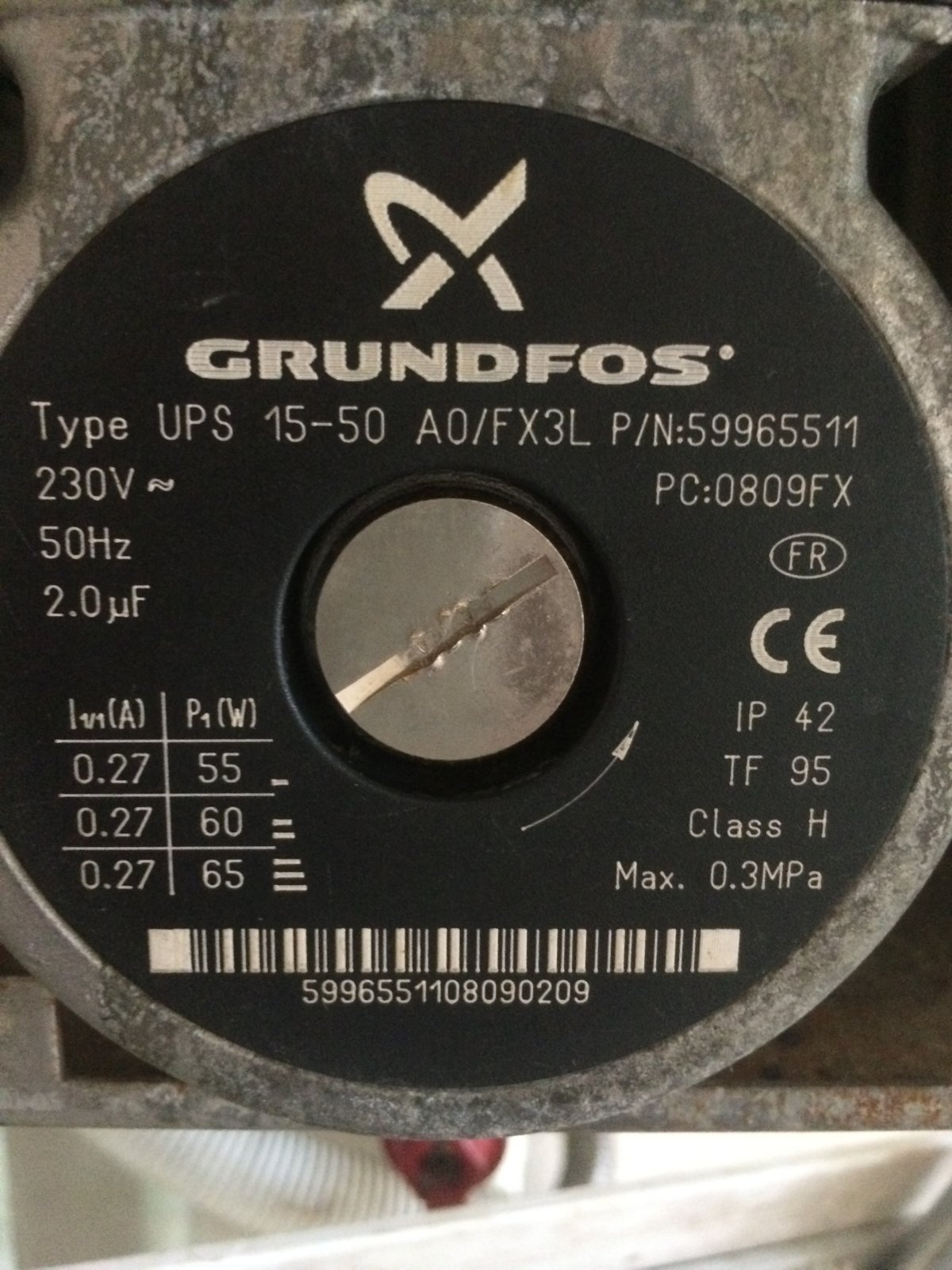

The Ferroli boiler in one of my rental flat's is playing up again, i had it going by replacing the PCB and has run fine for a few weeks BUT the RCD is tripping again as soon as boiler is powered up.
When i disconnect the CH pump it is fine, no trips BUT obviously no CH, so i presume 99% the pump is faulty (i will Megger the existing when i get chance).
It is flange mounted with 4 allen bolts so looks simple to replace BUT i wanted to know the following -
Where can i source a replacement cheaply ?
How do i drain the boiler etc in order to replce it etc..?
Boiler is a Ferroli Domicompact F24B - http://www.ferroli.co.uk/wp-content/uploads/brochures/archives/DOMIcompact F24 B Manual.pdf
Pic below is of the pump -
Cheers
