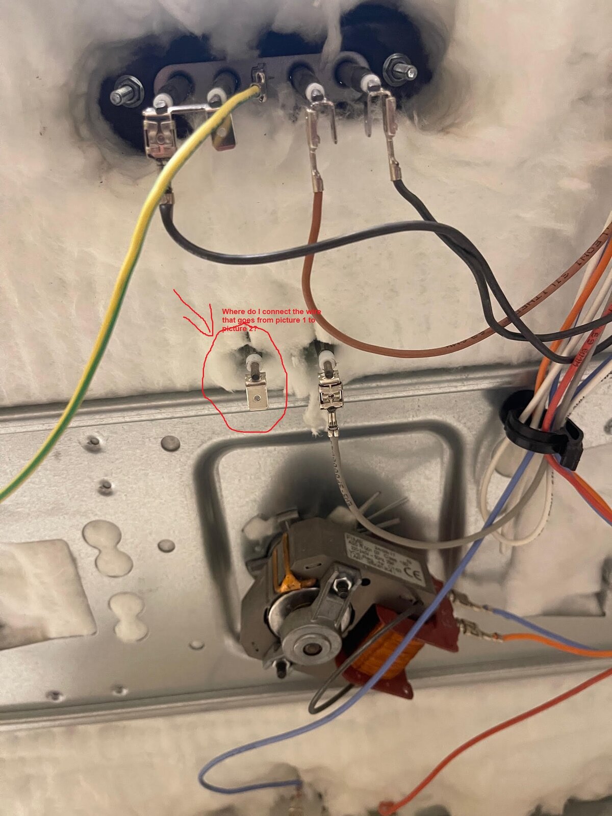

Hi,
Can someone help me with photos or a diagram for the electrical circuits of an AEG BCE 451350M oven?
I don't know how and where to connect the wires coming from the middle heating resistance (from the back).
Thank you in advance !

Do you mean you want to replace a faulty oven heating element? Post some photos please. You shouldn't need a wiring diagram, they usually just plug in.
Thank you for replay.

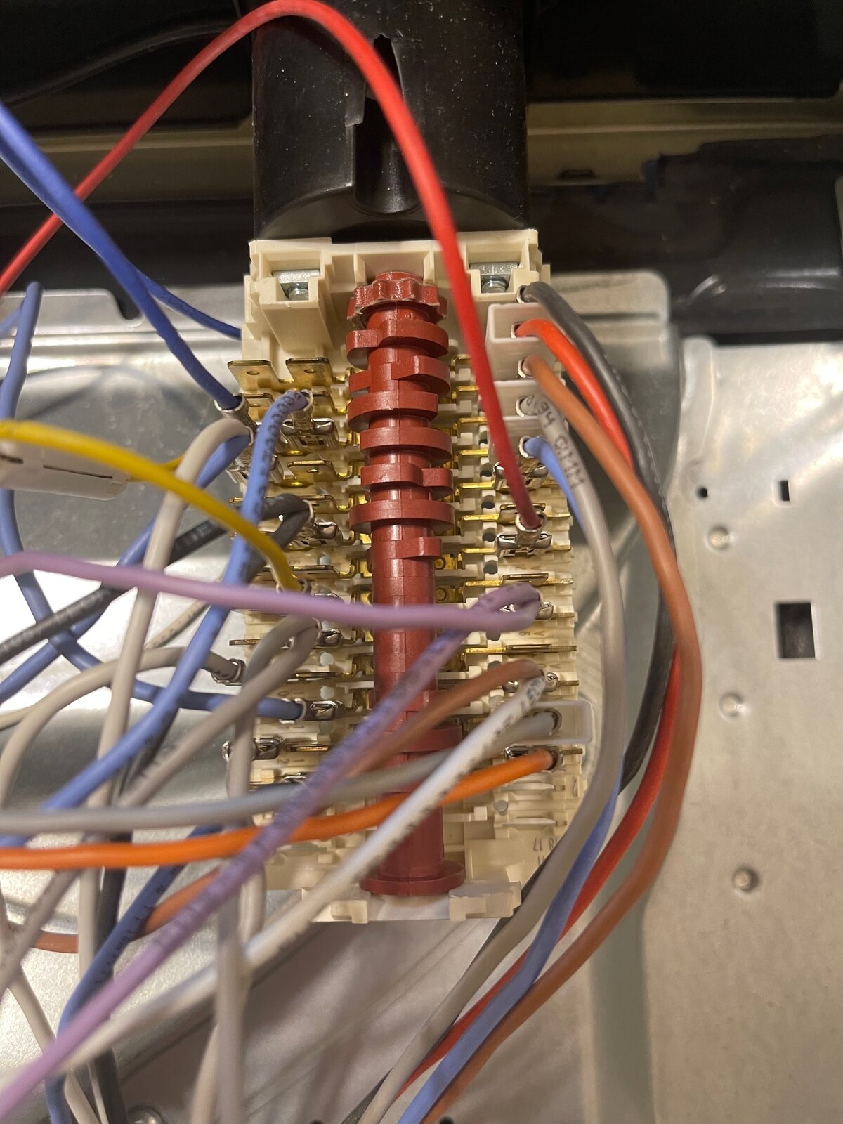

I attached 2 photos.
I need to find out where do I connect the wire that goes from middle heating element in photo 1, (I circled the resistance in red), to which connector of the switch in picture 2?

Sorry I can't tell. I can see the main heating element for the fan oven above it, what does this little thing do? What happened to the original wire?
I do not know. An "expert" wanted to replace the main heating element and the wire and forgot where he got it from...
The brown wire above it looks like the correct length and shape to have come from that terminal, but you would need to test it with a meter (power off) to see what it does.
It’s not the white wire on the right, looped back through the black cable clip, is it? He might have tucked it there for stowing.
It will be there somewhere.
