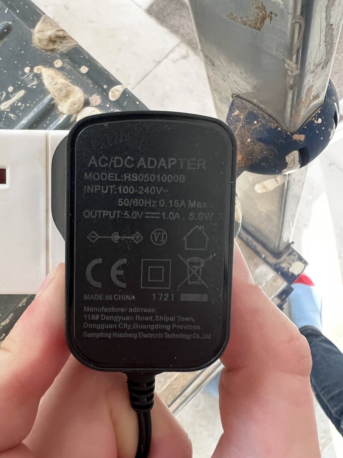

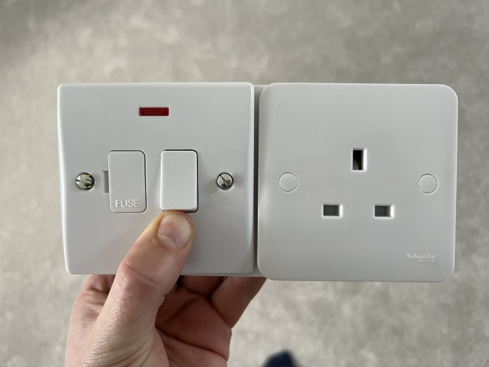

I've got a TV aerial in the loft which needs a power supply (see Pic 1) which seems to promise not to draw more than 0.15A. I've created a socket and fused switch in one with a 3A fuse (the smallest I could find, see Pic 2) and was planning on cutting into the 3 x 1.0 + 1.0 cable, taking the neutral, permanent line and cpc through the input side of my fused switch and then back out again to carry on their run, whilst running my socket from the output side into which I would plug just the aerial adapter. I'll also label it clearly.
What are everyone's thoughts on that? Reasonable, or am I going to kill everyone? Incidentally so that no one comes along and plugs in 3 hairdryers and an air con unit I will remove it and Wago-connector it back to it's original configuration before I move out (years away yet, anyway!)
