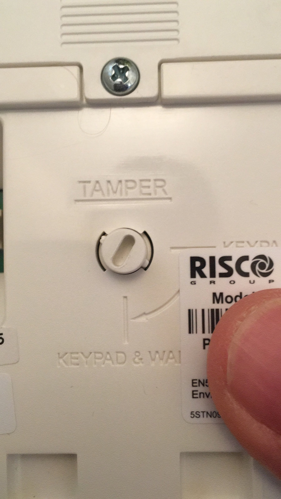

We have the Risco Agility 3 installed. The batteries for the Wireless Keypad ran out so i called the installer who quoted £90 call out plus £65 for batteries. I thought that was a little steep and the guy said i could change them myself. I got decent batteries for £20 and changed them myself. The keypad now works however every few days when setting or unsetting the alarm a 'Tamper Alarm' goes off (once at 4am, our baby didn't wake up but all the neighbours did!). I can deactivate the alarm using the keypad but it goes off again a few days later when activating or deactivating.
What do i need to do to stop the Tamper Alarm going off? Is there an option in the setting menu? Or is this something that has to be done with the Engineering Code?

Tamper alarm, have you checked whats in tamper did you put keypad back properly?

The fault states 'Tamper - Partition 1 Keypad'
I have cheked and the switch is sticking out and touching the wall, it makes a slight click when placing the keypad back on the wall which makes me think it is making contact.

if the keypad is in tamper I would check its seated properly, biggest cause of keypad tampers is not correctly seating them.
you could short term, use flat headed screwdriver and secure the tamper with a shortquarter turn.
Seems to be seated ok
I'll monitor for a few days and see if it goes off.
