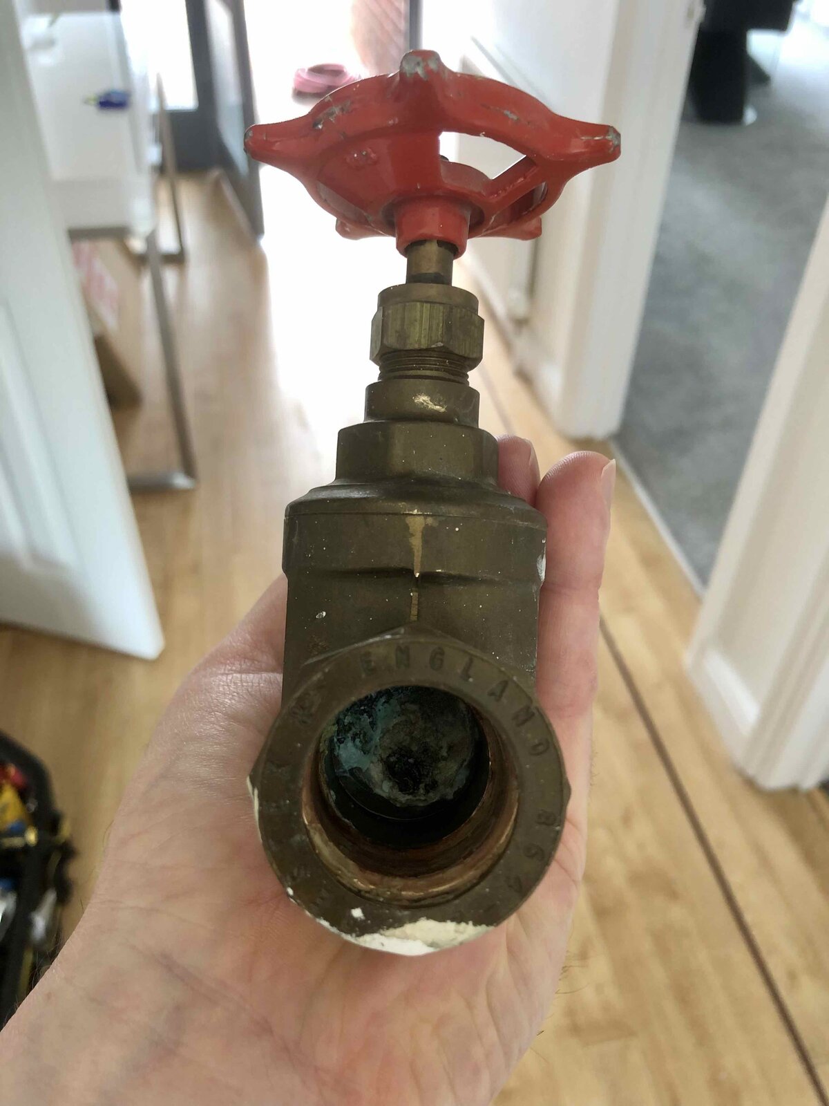

Hi guys

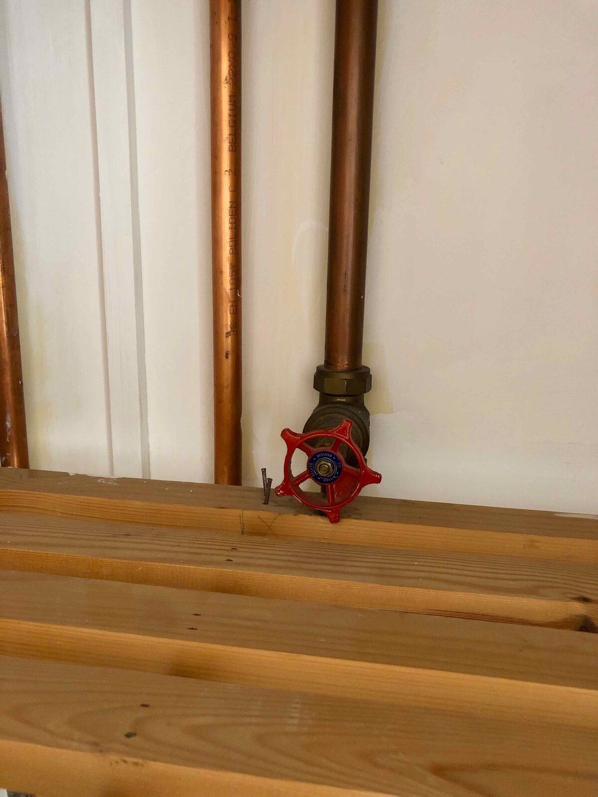

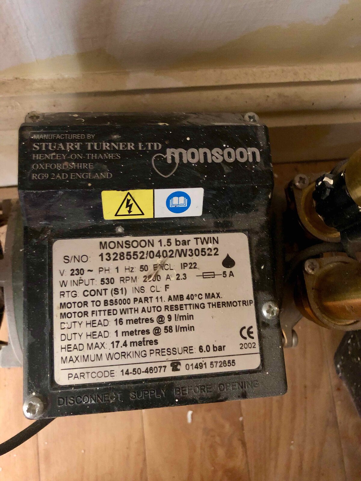

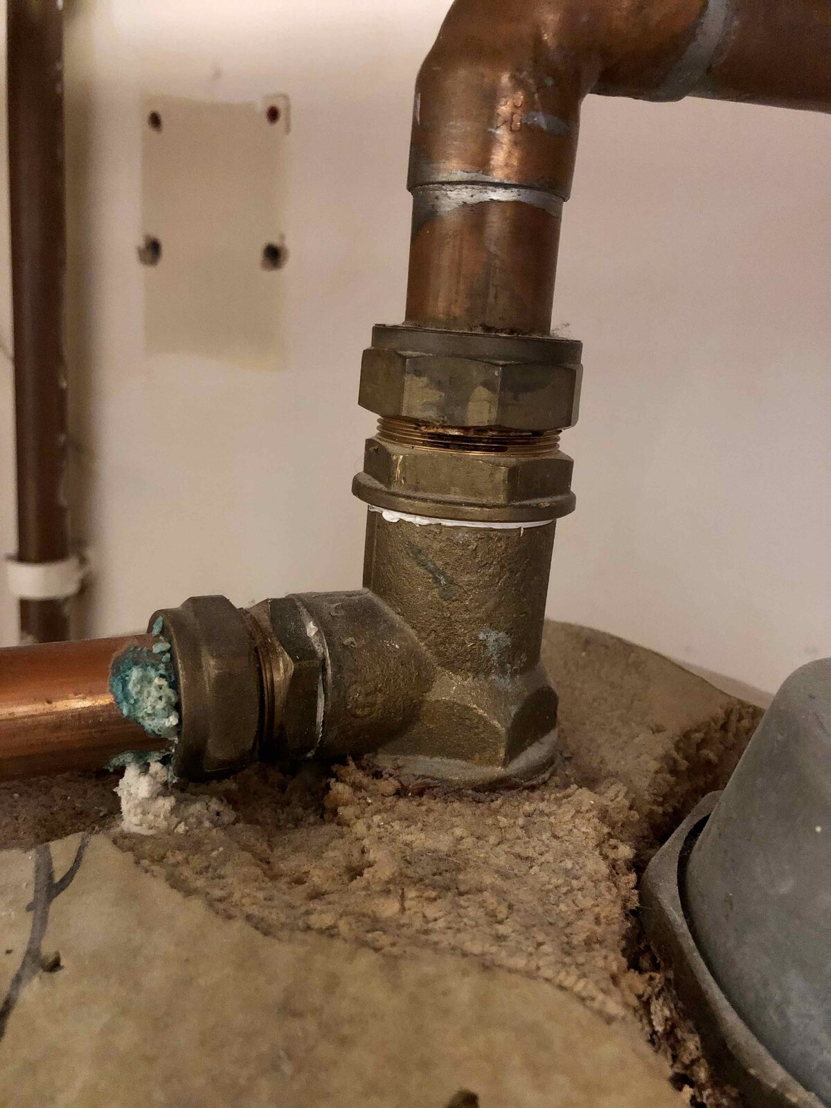

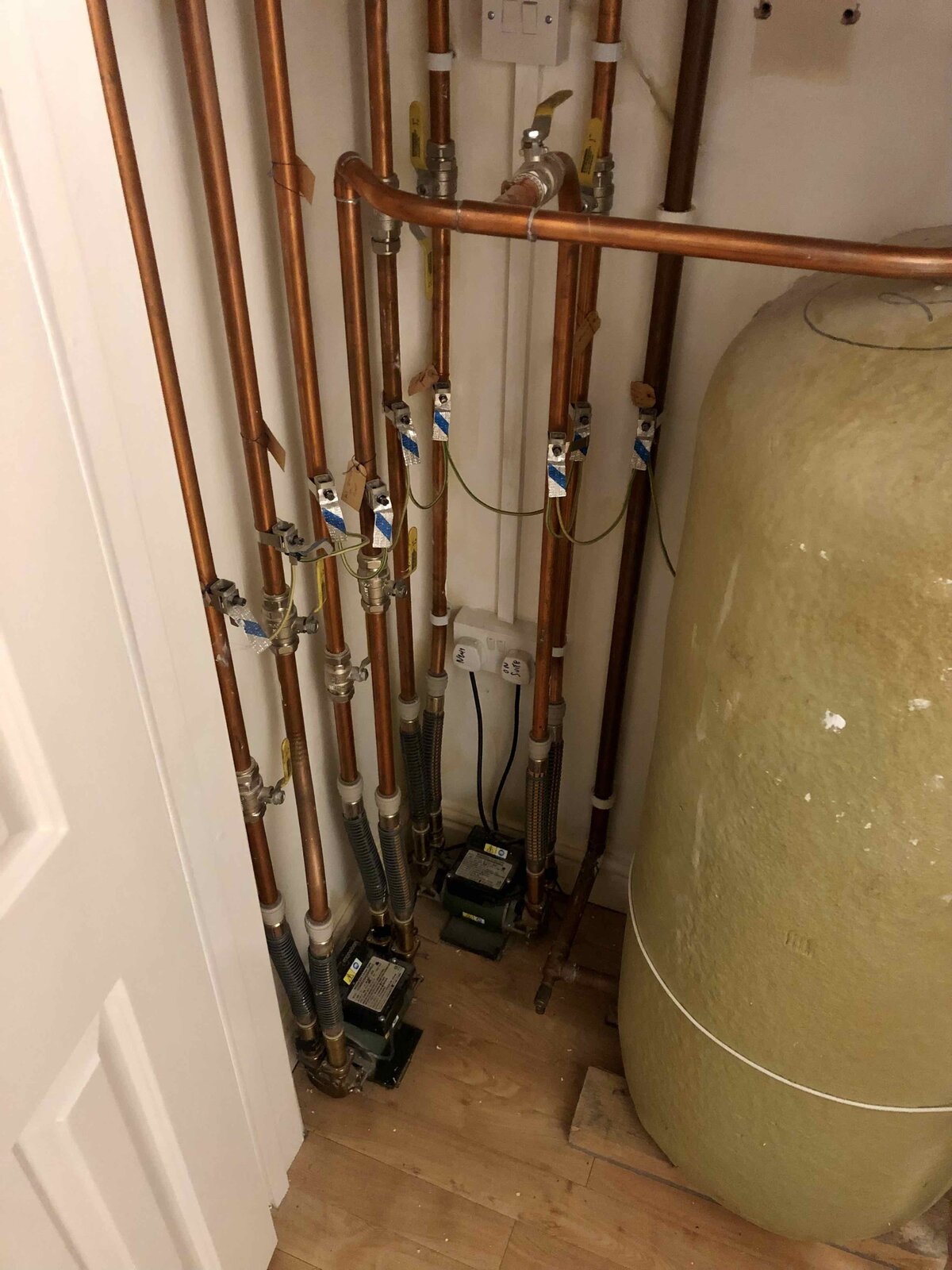

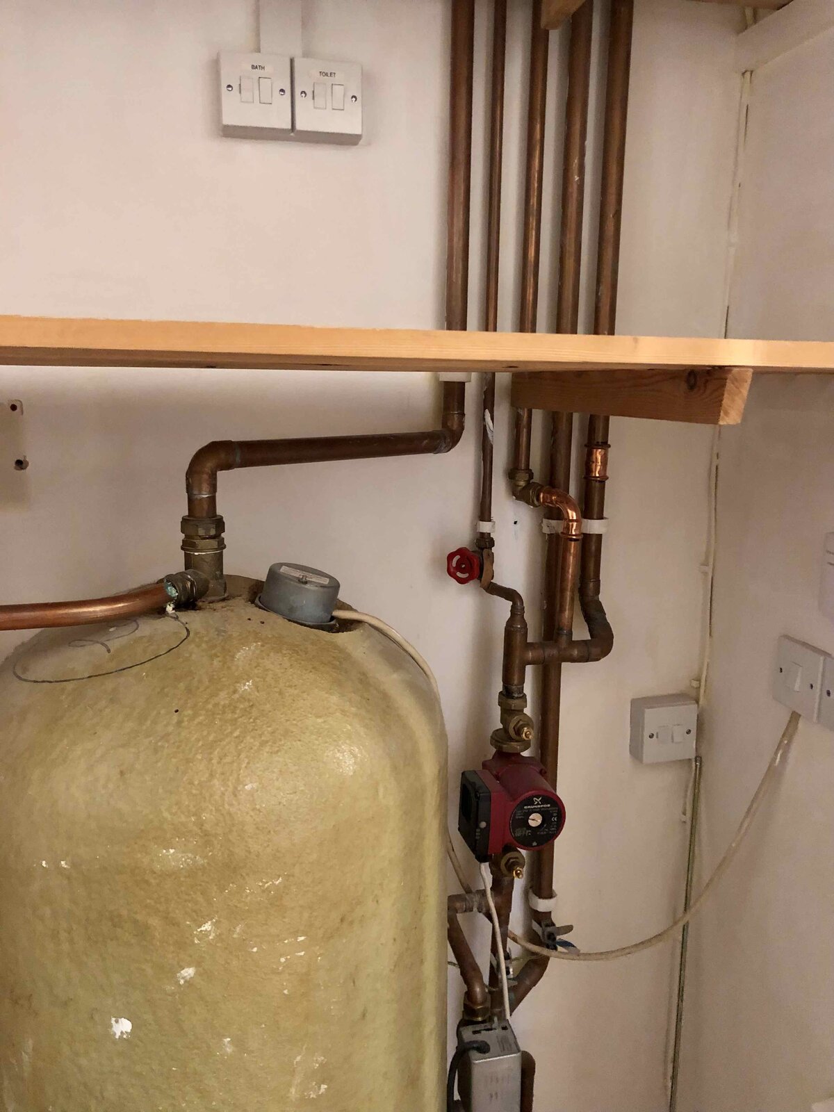

We have a gravity fed hot water system in our bungalow heated indirectly by an oil boiler.
We have two shower pumps. One pump feeds one bathroom (the shower and bath) and the other pump feeds the other bathroom (the shower, bath and the hot feed to the bidet and sink). Non-pumped hot supply to other two sinks.
We recently changed the kitchen tap (non-pumped) and found the hot flow was pretty poor. So we had this tap swapped from the non-pumped hot supply to the pumped supply shared with one of the bathrooms (the one with the pumped bidet and sink).
There now appears to be air getting into the system. This was never a problem before. Interestingly, this is happening to both pumps! The showers tend to only last a couple of minutes before slowing down and stopping completely. The hot water sometimes doesn't come out of the taps at all. Air is coming through. After we've used hot water, the pump sometimes starts and stops on its own. We can use the showers by making sure they are set to slow flow only.
I initially thought air was trapped in the system but it seems like new air is being drawn in. Not sure what the problem could be or what to do. The guy who did the job is coming back next week.
All thoughts and advice appreciated!
Mark
