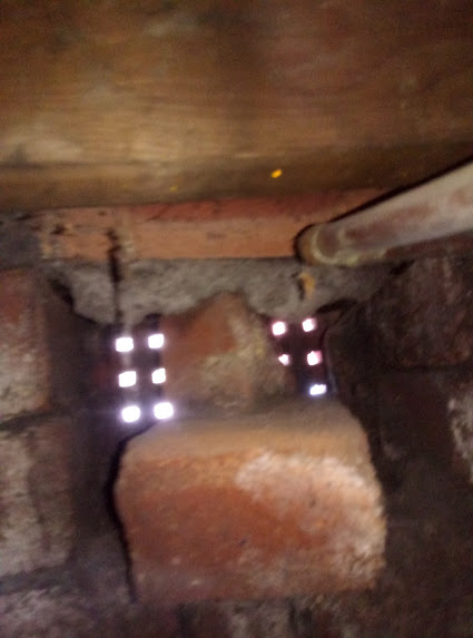

Hi, I have an air brick blocked with another brick. The brick blocking the air brick is supporting the brick above. See photo. Not sure how to tackle this. Any ideas
If the mortar is hard you could probably just take the supporting brick out. Otherwise replace it with something more conducive to airflow. Short length of tube. Maybe scaffold tube? Just cut it a mm short and hammer it home.
