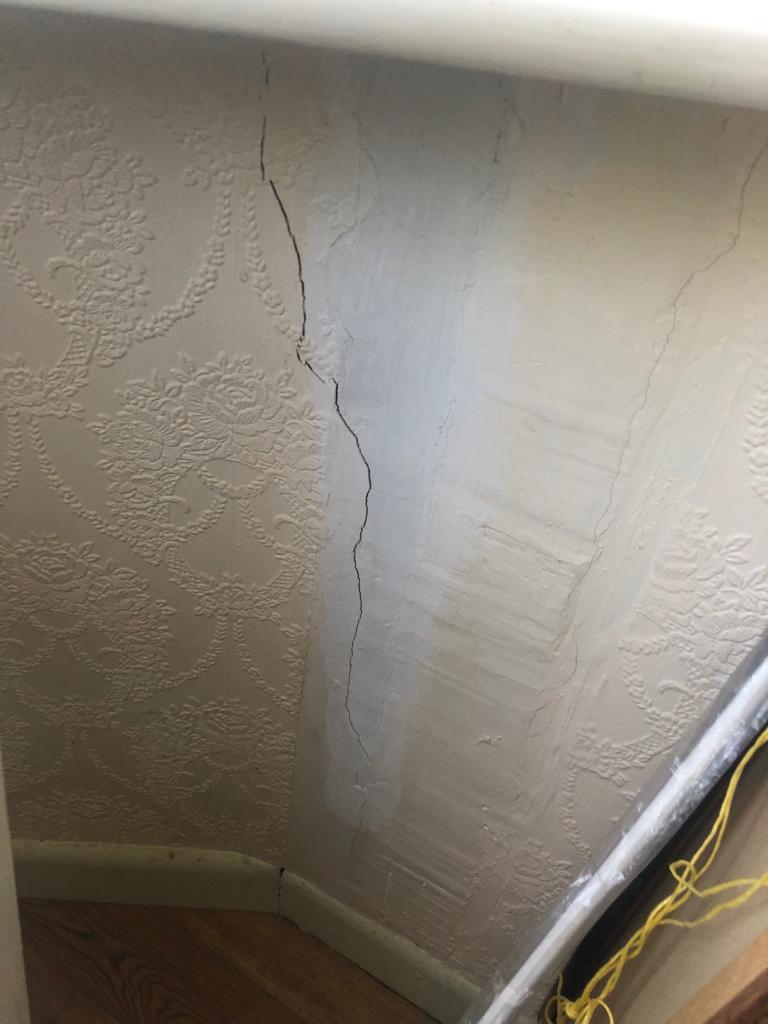

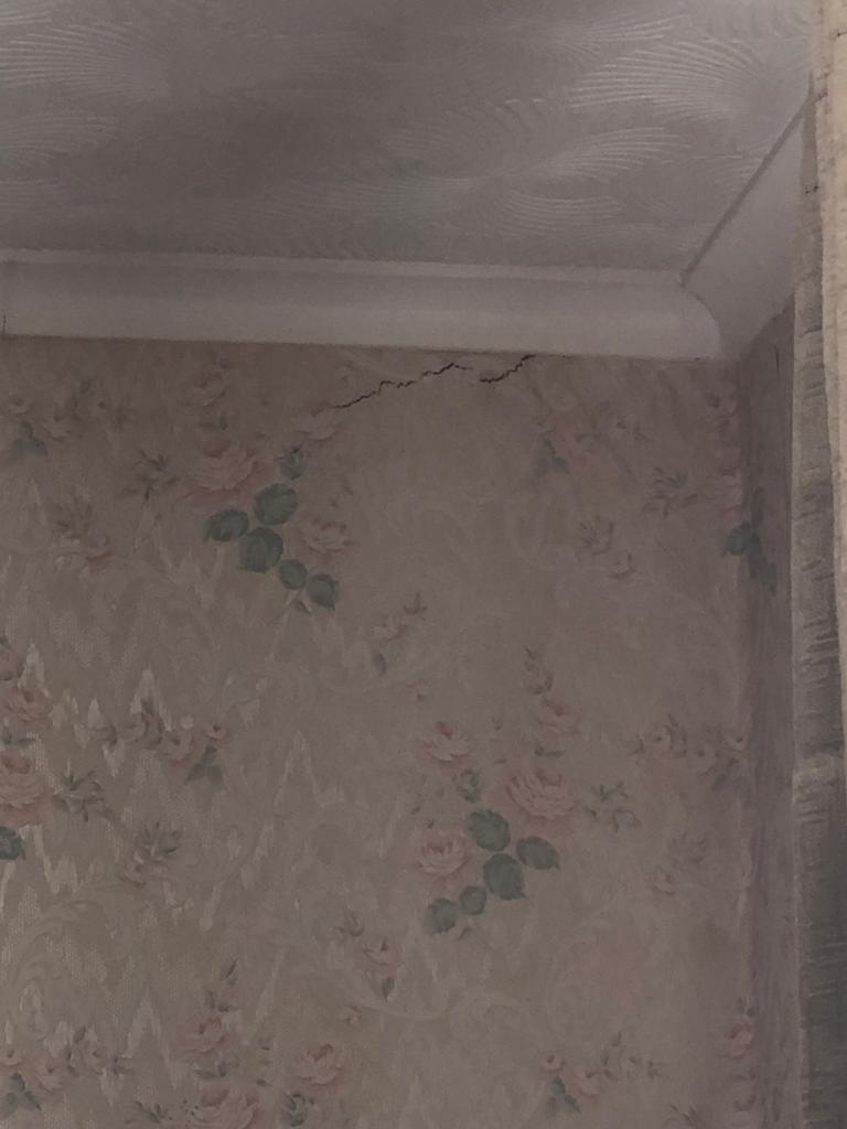

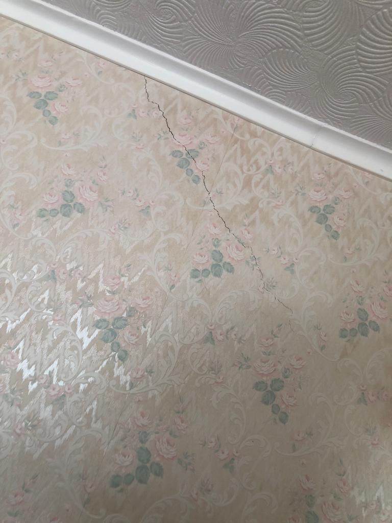

We have had 2 people out to the property so just waiting on the report back hopefully this week. I assume both have turned up with spirit levels! There are noticeable cracks in the bedrooms that come through the old wallpaper from the ceiling down the wall. It is an old property so its expected I suppose.
Assume nothing! The directions and sizes of these cracks are important- generally diagonal more likely to be bad news
They are diagonal :/ There is a few pics

Does the bay run full height or is it just ground floor? Are the bay windows original timber or modern plastic? If plastic, try a magnet in the poles between windows, see if there's lots of metal in there (not infallible alas, some bay poles are aluminium), if the top windows are openers do they open and close easily and smoothly (no jamming). When you open the window, have a look in the frame - there'll very often be a manufacturing date for the profile (which may tell you a lot about the honesty of the vendor)
The other 2- which walls are they in? They aren't big but look relatively recent, possibly purely caused by the place standing empty and (presumably) unheated for some years.
The crack to the bay window are in the front bedroom (first floor). There are cracks either side of the wall from under the window sill to the ground and also hair line cracks running from the ceiling to the window sill. I know that the windows have been replaced twice. The original ones where a wooden brown frame, then wete then replaced to white pvc with 5 square window panes at the top (3 of which open, side, middle and side) and they have been replaced again with 4 window panes at the top (2 of which open each side) I assume the load bearing weight when replacing the windows hasn't been sufficient which has then caused cracks in the wall to the top bay?
The other cracks are the back bedroom. There has been an old lady living in there since March this year when the house went up for sale and its been occupied by her I assume since the 60s. So I assume its been kept warm as that room showing the cracks was her bedroom.
Yes to the windows quite likely not installed with any or much attention to the loadings especially on the ground floor-look for any bowing in the top of the frames. The 'structure' of those fullheight bays is sometimes not that substantial either (bits of 2 x 2 with tiles hung on the front) so there may be elements of sag coming from them.
The cracks- without being able to see the whole building it is difficult to draw any definitive conclusions but they don't look particularly active or particularly big
