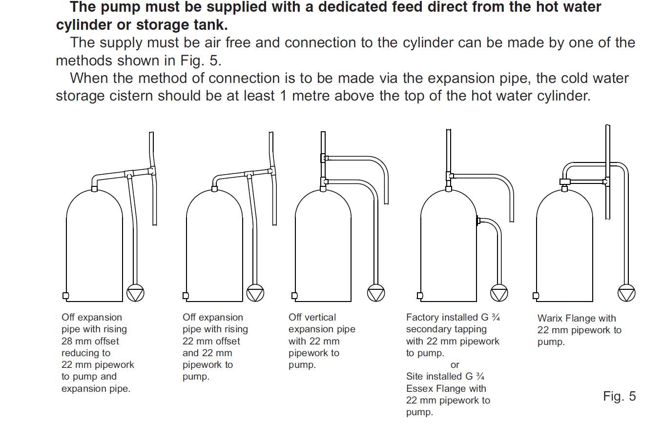

The vent should, where possible rise straight up from the cylinder top, if the HW outlet & vent is taken from the side of the tank then its inevitable that air will eventually build up in the cylinder top and force down the water level to allow air ingress to the HW outlet.
Can you post a photo of the HW cylinder showing the vent and where the HW is drawn off?.
One of these might help.
Except you have a problem like suggested in post #2 then installation should be like below.
The "warix" flange is like the one I showed above, under various names like surrey flange.
