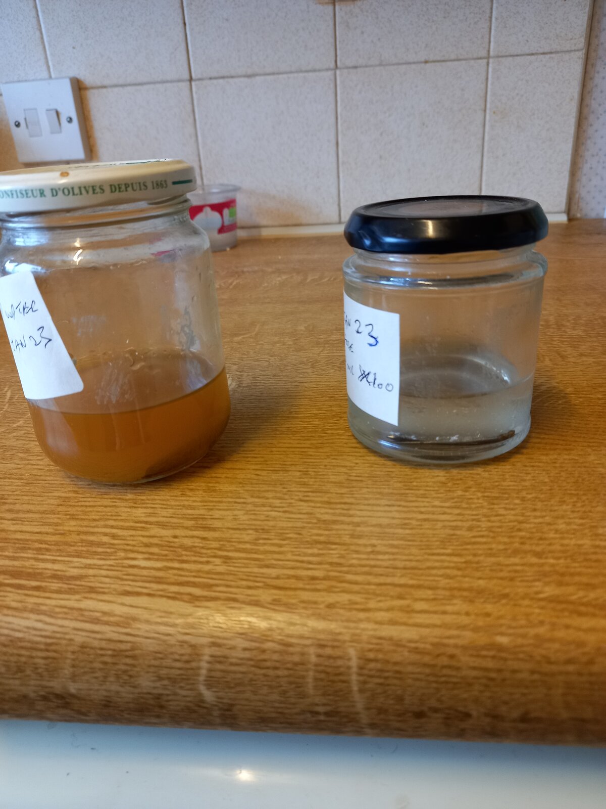

Worth doing a bright wire nail test to check for corrosion. Come back if you want details.
Yes please. Never heard of it
Put some water from the system into a jam jar to about 1" deep. Put some tap water in another jar as a a check. Add 3-4 bright wire steel nails, and leave for a couple of weeks. If the water stays clear you're OK, if it goes brown you need inhibitor.
If you have a Magnaclean or similar it's ideal for taking the sample and for adding inhibitor, a bit more trouble otherwise, need to get it from a bleed screw or something.
Here's one I did on my system earlier this year. Tap water on the left!
