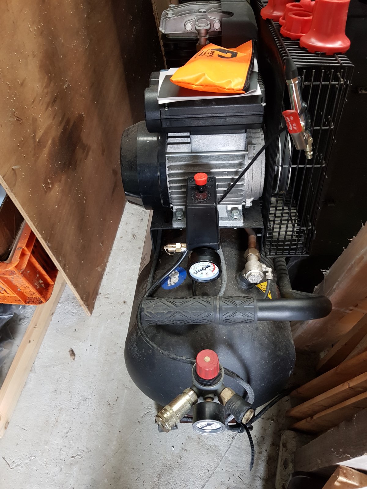

I bought an airline with blissful naivete and it doesn't fit my compressor. The airline uses PCL nozzles, and the compressor uses, erm, something else. Not sure if it's Euro, or NPT, or whether they're even the same thing. Before I spend my remaining pennies on all the different connectors under the sun, can someone offer some advice?
The one thing it's too late to change is the compressor, a Scheppach HC53DC. If anyone owns one of these or knows something about them, can you please advise which type of connector I need? Unbelievably, the instruction manual does not mention the connector types.

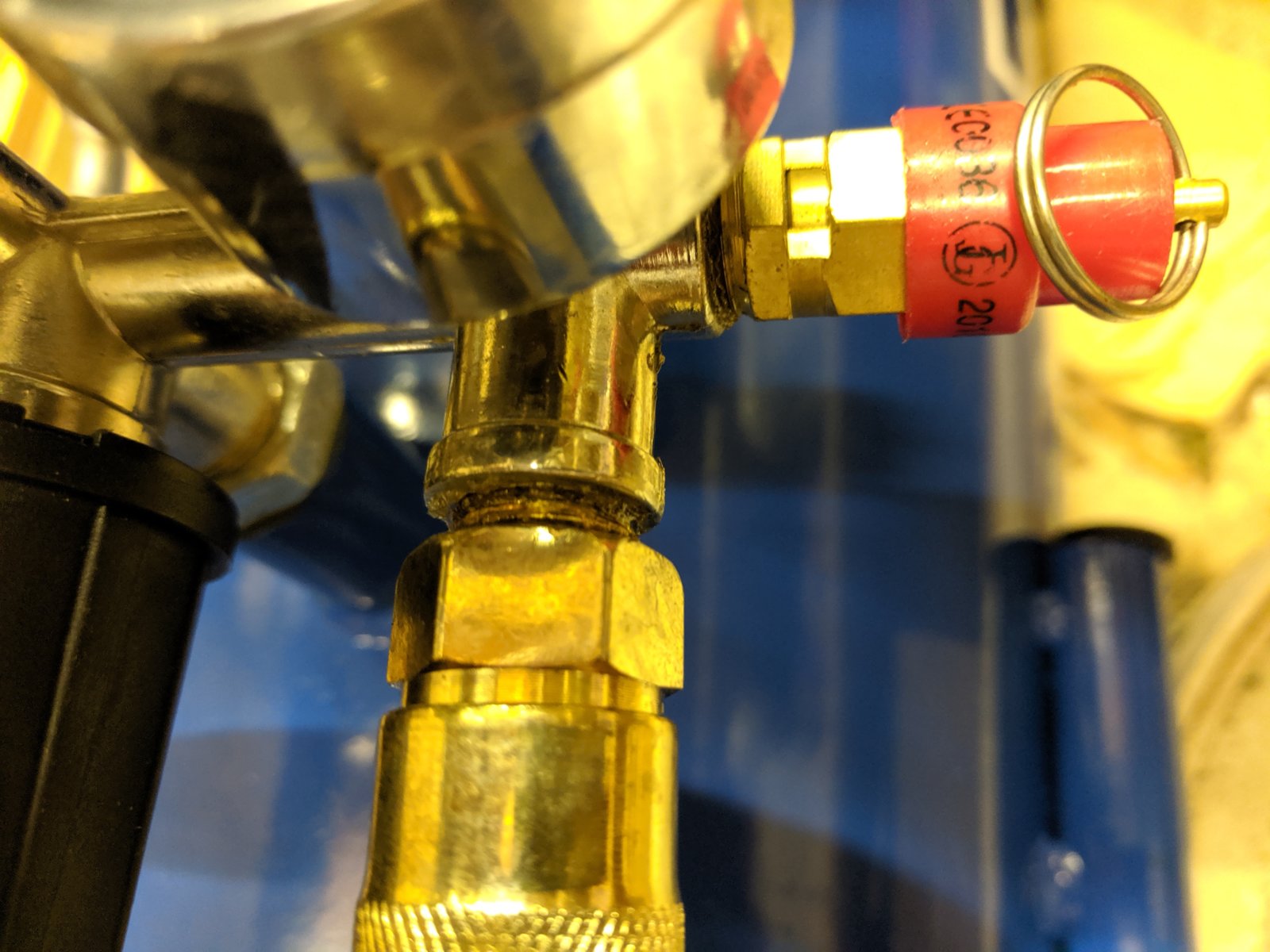

Thanks Burnerman , the compressor outlets are already fitted with female QR connectors rather than BSP threaded; and my PCL males don't fit. I assume they're Euro, given that Scheppach are a German company. I've just gone and ordered a set of adaptors and my fingers and toes are firmly crossed :)
Surely the QR outlets are threaded into the manifold.....?
John :)
Yes they are, but looking closely at then they have some sort of compound (glue or something) involved, so I'd be worried about unscrewing them in case they damage the manifold. I've tried to upload a picture, it's not clear, it almost looks like it's been braised in place.
I've never seen them brazed in place, more likely to be a sealing compound with ptfe tape. My own compressor came with taps, which I changed as they were reducing the air output.
John :)
They may use sealing paste (I have a bottle of liquid PTFE for air fittings).
That connector will unscrew and just fit a Female PCL in its place (with male 1/4 BSP end).
I went PCL for all my tools and air lines, a lot simpler with just one fitting.
I still have a Euro connector as well as PCL on the compressor just in case but never used it.
