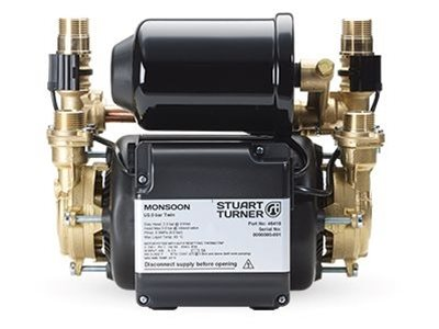

I have a condensing boiler with separate hot water cylinder adjacent on the ground floor. The house is 20m long so I have to have an electric pump for the domestic hot water. When the hot water is switched on ie for a shower the pump comes on automatically and switches off when the shower etc. is turned off. However somehow air has got into this system so that when the shower etc. is switched off the pump comes on by itself for 30 seconds or so and repeats this for about 5 minutes or more(sometimes 15 minutes). Has anyone any idea how this problem can be fixed? I have had an experienced plumber to try and fix it but to no avail.

Pictures please - if there's a small chamber on top of it then that could be the expansion vessel of a universal (negative head) pump
What make is it? does it look something like this?
It is what trojanhawrs is saying, a Salamander pump, either a CT Force 20 SU or 30SU
As madrab says check the vessel.
Unplug the pump. Screw the valve cap off, it's like a bike or car tyre valve. Give it a wee press with a small screwdriver or your fingernail, If water comes out the bladder is burst and vessel needs replaced. If air or nothing comes out put your bike pump on it and inflate to 32 psi.
