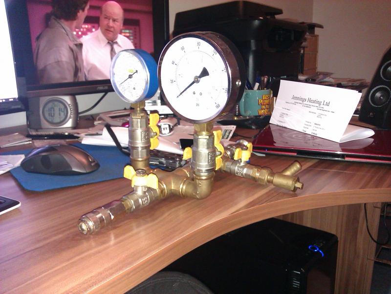

Fittings are easy enough to rig up as compressor tools use a standard thread.
Here's my rig...
Nice little ad in the background from that headed notepaper Dan, just in case someone can't find your details by looking at your profile, eh? ;)
