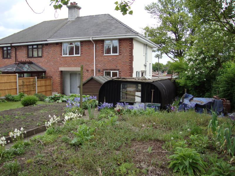

A house i have brought to do up has what I think is an air raid shelter. THe previous owner has taken it apart and converted it into a garage. The middle of the roof is corogated plastic while the metal air raid sides are buried in concrete. Whats the best way to remove. See pic..
Send the Jerries in ;)
Or cut it up in to manageable pieces, using an angle grinder with a metal cutting disc. Then off to the scrapers with it. Plastic to local tip.
Then a breaker for the concrete.
