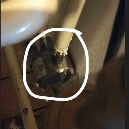

Hi,
My heating / hot water system keeps pumping over.
The hot water goes up the open vent pipe and into the small tank above my hot water cylinder.
It seems that the problem is around the air separator, it gurgles and makes a lot of noise before sending the water straight up the vent pipe.
I have also noticed that the pipe leading from the air separator to the pump is a bit magnetic.
Please see the picture below;
View media item 78769
The water comes in, gurgles, then goes up the vent (blue arrows and circle).
The red outline shows the area where the pipe is magnetic.
Just below the red area is where the cold feed enters, could I undo the elbow on this pipe and use a coat hanger to try and free up the pipe?
(assuming it is clogged up)
Heat does make it through to the radiators/cylinder but its very noisy and takes a long time.
What is the best thing to do here?
if you are not comfortable/experienced with it, get someone in
or cut ir out and replace with new pipework or another air seperator
cutting it out will allow you access to see how bad the extent of the blockage
is and you may consider replacing a section of the pipework at the same time
toolstation sell the air seperators item 75473 £14
It definitely needs to be unblocked and you can do this however you feel a easiest. But be aware that it will only settle somewhere else in the system. It may be more beneficial to clear the blockage then add a litre of good quality cleaner like sentinel for every ten radiators on your system. Leave for a week or two to circulate at the boilers maximum setting. Heat helps. Then drain the entire system. Repeat a couple of times as you're doing it yourself and it's inexpensive to clear as much sludge etc. out of the system. Add inhibitor when you finally fill it up again.
If you're still having problems after this you should consider a proper powerflush. You're system will be very inefficient if you only clear the blockage.
The 22mm pipe between the air separator and pump is about 60cm long.
If I get a new section of pipe and a new air separator, how much should I be charged to replace these parts?
I can also drain down the system before the plumber arrives to save time.
The air separators usually get blocked with limescale and this is almost impossible to remove. Cutting out and replacing it all is the only viable option.

As suggested above, the first task is to identify the system fault and rectify that.
Clearly the system has been installed wrong or modified.
The system is from the early nineties, over 20 years old, so I think it's age more than anything.
Also at some point it had a cardboard lid on the tank, which ended up in the system, I cleared it out last year wth fernox but now the above problems here.
why not phone some local lads, desrcibe the problem and ask for a quote/visit
you would then have a much better idea.the longer you leave it the worse it will get, so needs sorting out bud but pay attention to whats been advised especially acl plumbing
cutting out and replacing in that area is only a small aspect of the overall problem, dirt /sludge in your system
