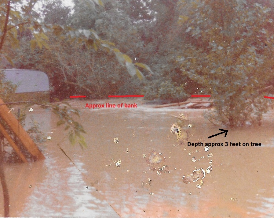

In 1979 we bought a plot of land to build our home on, at the time there was no gas supply so "alternative" electrical heating was on the agenda. With over a year to wait before we could start the build there was plenty of time to research heat pump systems. We had a babbling brook as our boundary so we had options of water source as well as air source.
The Philips Experimental House project at Aachen provided us with masses of data. Additional data came from a various sources such as NCAT ( now CAT ) at Machynlleth
The conclusion was that air source heat pumping was excellent in summer for both supply of hot water and cooling of the house. What it could not garantee was heating of the house in winter as evaporators ( the outdoor heat exchangers ) would be prone to icing up and would then require electrical heating to de-ice them.
The conclusion was that water sourced from the babbling brook was viable and was planned to be installed until this once in 100 years event happened while we were building.
Installing the evaporators in a way that would withstand a flash flood was nigh on impossible so the idea was shelved.
