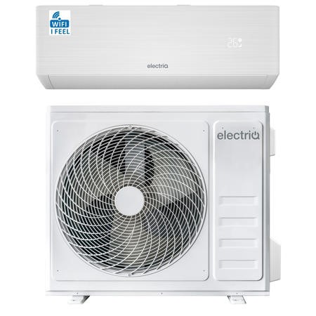

I've got a large extention to heat, approx 9m x 7m.
Has anyone installed an air to air heat pump system like the pic?
Seems a win win, heating in the winter and air con in the summer.
Any thoughts?
This one says its 28000 btu, not sure though if that's the hearing side or cooling side (or both).
unless the cop rating is about 4 it will be more expensive to run than gas as electric is 3 -4 times the cost off gas per kwh
28000 BTU for a 60sqm room is kinda insane; the heat pump for my entire house is less than that
Are you planning on having huge swathes of south facing glass and going as skinny on insulation as regs will allow? Don't..
