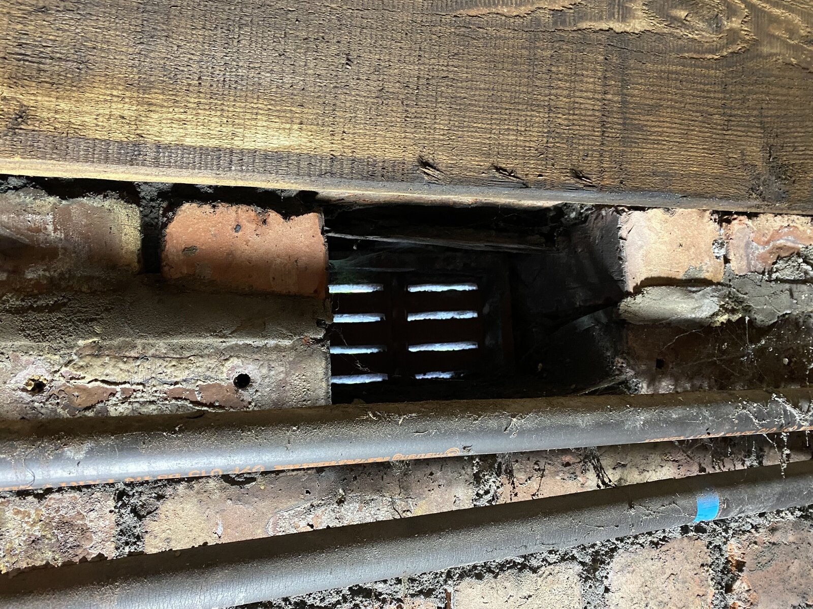

We live in a 1920s solid-walled house (red brick, cement rendered) that has a tendency towards dampness in the basement. Generally it’s all in check but we do get the odd issue here or there.
When we moved in we had gas heating installed and the meter box is located externally on a bay wall, unfortunately we had to have one of the airbricks removed and the hole filled as they won’t mount the meter otherwise.
Gradually we’ve noticed damp starting internally on this wall that we are pretty sure wasn’t there before. I was suspicious it’s something to do with filling the vent as something could be bridging the DPC. I had a hunt around in the basement and noticed that the hole hasn’t been fully-filled, instead only the front portion has been filled a little and rendered over.
Outside with the damp meter and the wall is good, apart from the filled in section that’s going off the scale (30%+) So I’m thinking this is the problem, I just don’t know how to solve it. As this portion of wall is now thinner, no doubt it is colder than the other walls so will be getting condensation internally. If I fill the hole completely, I will end up bridging the DPC, so that won’t fix it either. I can’t move the meter as any other location would have the same problems on the front of this house. I can’t put in a new air brick either.
I’ve covered the outside area with some waterproof tape and DPM as a temporary ‘wonder if this will fix it’, but it’s not a permanent solution even if it does work.
Any suggestions appreciated as I’m pretty much out of ideas.

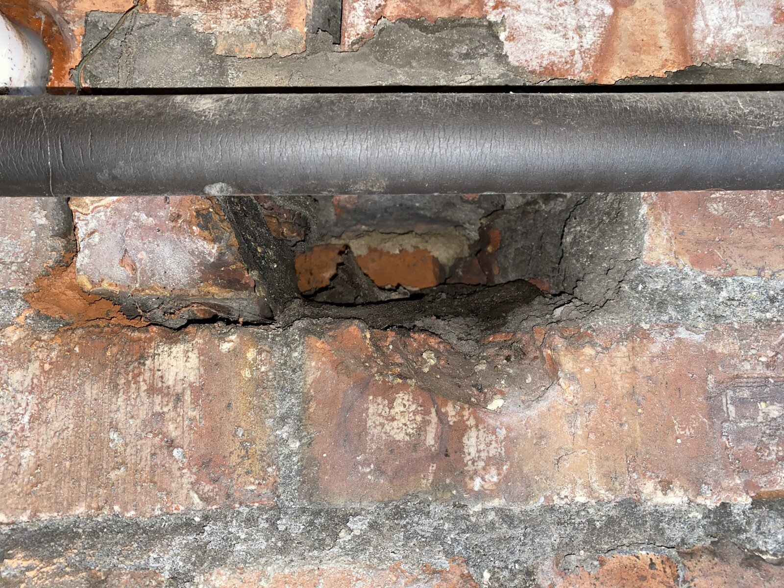

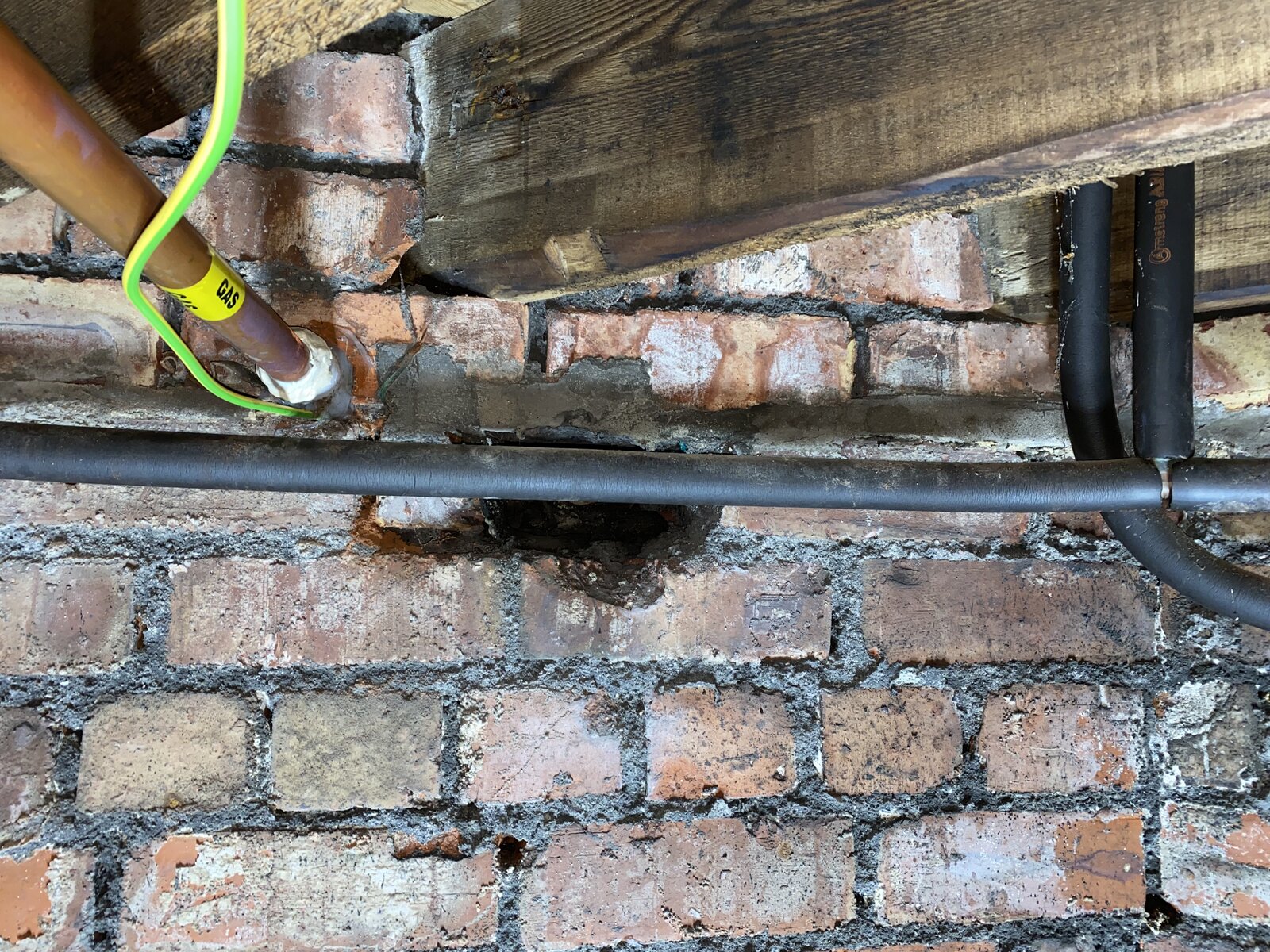

Can you take a picture of the inside where they haven't filled in fully and one from outside showing where the air brick was?
If they have installed the meter over the original air brick you may be able to install a new one a few bricks further along.

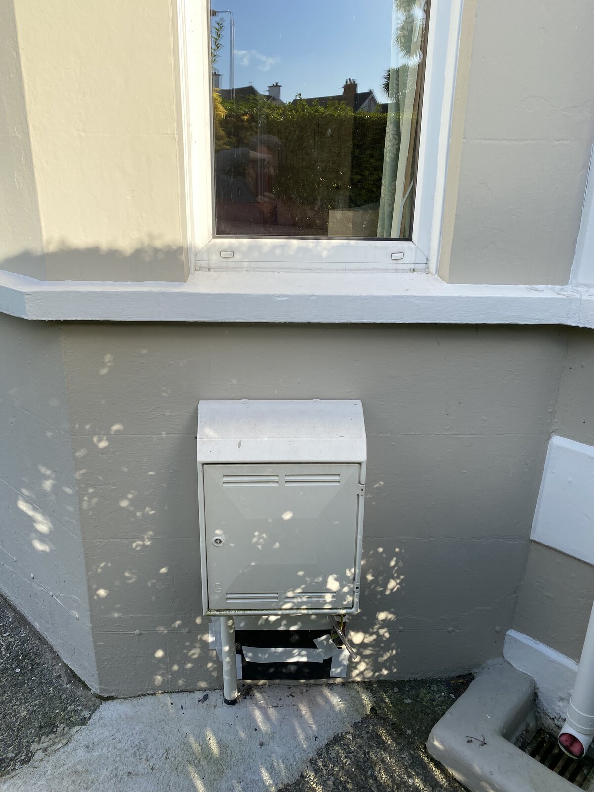

The gas meter can’t be installed within 1m of an air brick, there’s another air brick already on the front face of the bay. I also had a couple of extra vents installed a couple of years back, further back in the area to eliminate a ‘dead’ spot and get a decent through draft.
So I’m not overly bothered at losing the vent, I just can’t work out what the right way is to fill the hole effectively in a way that won’t bridge the damp proof course or result in a cold spot for condensation to settle on.

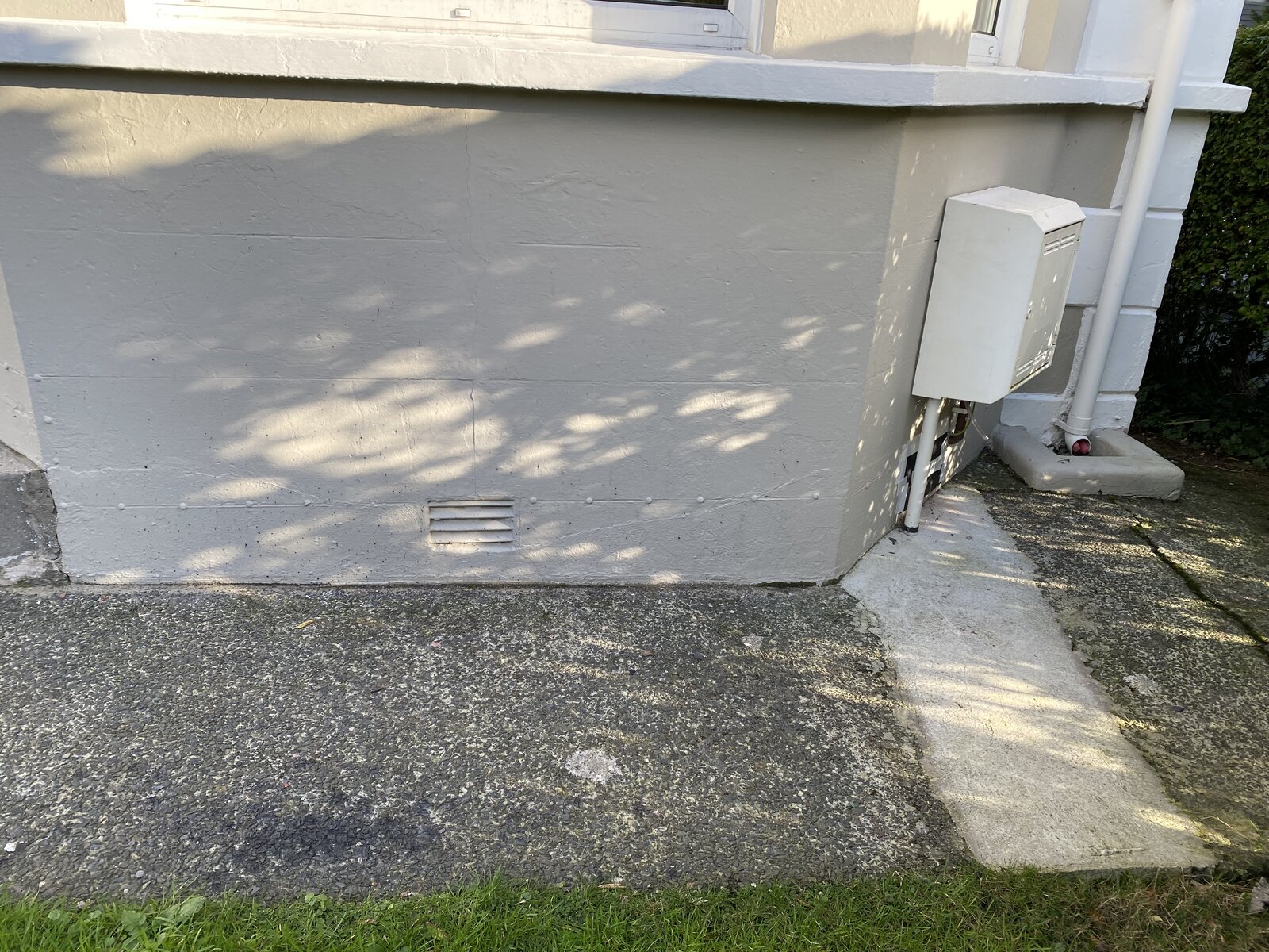

Here’s a few pics to help explain…. The taped over section below the gas meter is where the air brick used to be..

You should remove that render below the DPC - I'm surprised you haven't got extensive damp.

Just because all the other houses are rendered in the same way doesn't make it right. It needs to come off to above the dpc and it may be it was covering the damp previously but was disguised by the painted render.

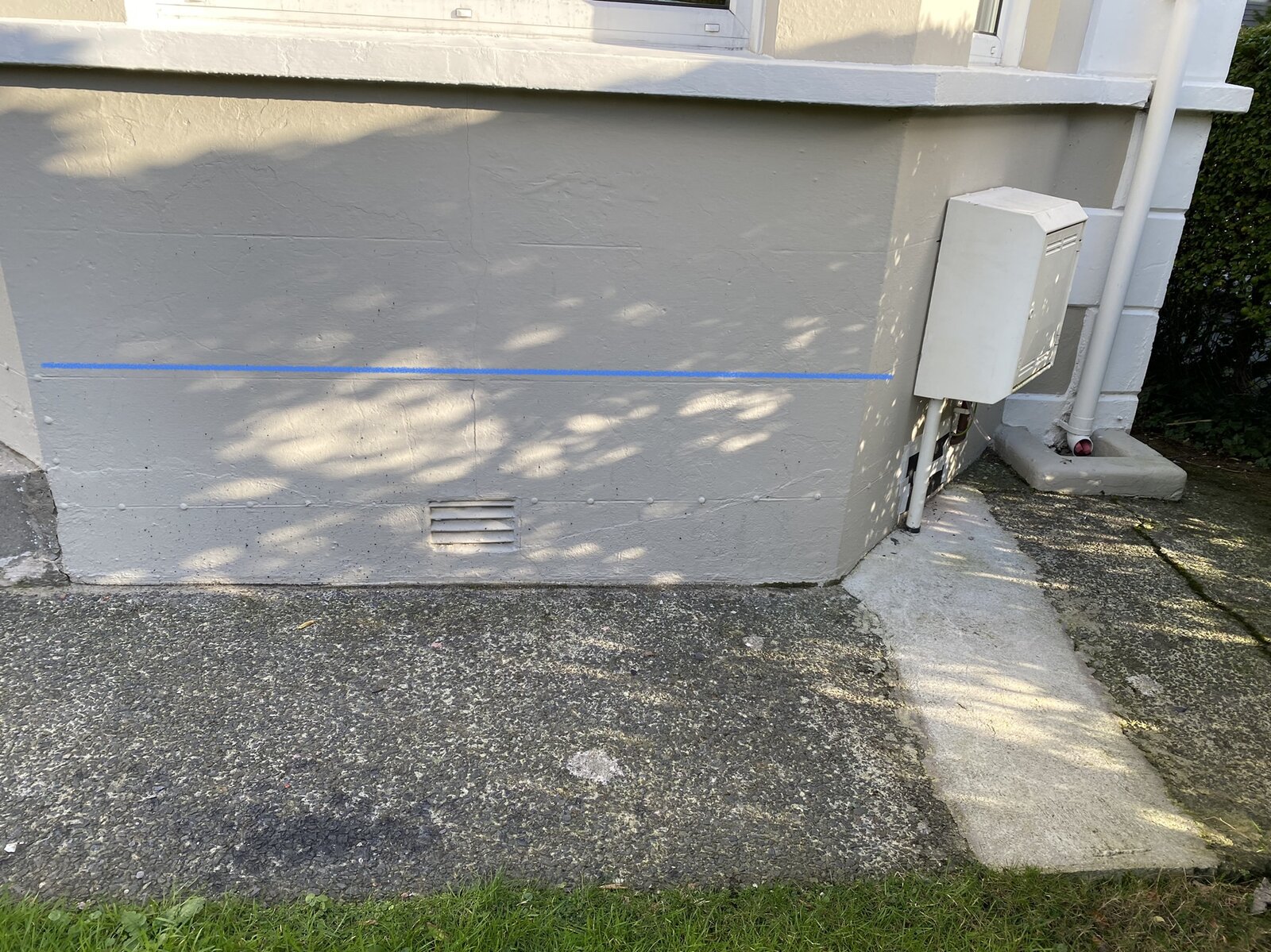

Can you show on a pic where your DPC is and where your FFL is?
You have historic damp injection holes and Pic 3 shows v. damp bed and bricks
and a joist with rot
- the left side of the bay shows a step-up that might be bridging any DPC?
As above, below the DPC remove all thick paint and render back to brick and end rendering with a Bellcast just above the DPC.

Regs gas meter distance from a air brick is 180mm - which you dont quite make. Brick up the opening after removing the tape stuff.

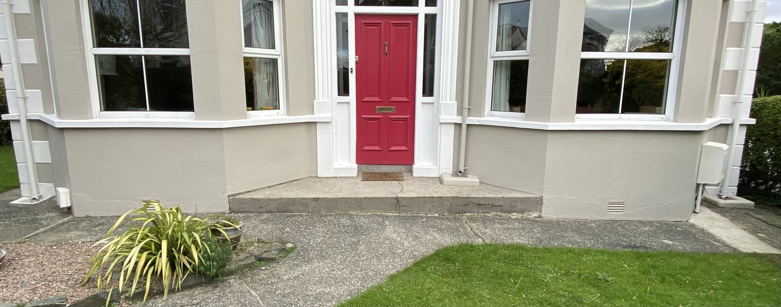

How many air bricks do you have in total on the front elevation?

In NI the gas supplier insists on a full 100cm between the gas meter and any air brick, they even moaned about the one that has been left open and carefully measured it with a tape... in total, there's 4 air bricks on the front (double-fronted) there's a further 3 on one side and 4 on the other, all clear and unobstructed, and all (just) above concrete path level. Yes, the raised step is the front door step and runs across from one bay to the other. There's no blocked up vent hole internally, so it's an always-been-there part of the house.

Just another couple of pictures for context - The blue line on the first image is the approximate FFL.
The 2nd image shows the whole front, with door step and air vents. I'm looking at that thinking it's interesting that the lower render (below the DPC) looks to have been patched in - it could just be from destruction when the injection DPC was put in, or it could be something completely different.
