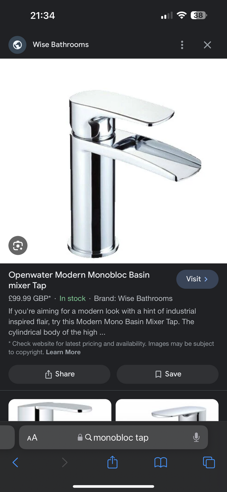

Hello, today I woke up to no cold water coming out of my bathroom tap or the toilet so I can not flush the toilet, hot water works fine. I’m not sure if the cold water works in the shower as the shower seems to only give warm water and it being stuck on that temperature.
the bathroom supply is from a tank above but I live in a council house, the kitchen water is supplied by a mains. I’m not sure what the problem is but I think it’s airlock and I was wondering what is the best method to fix this. I have a picture of my tap in the bathroom which makes me think I cannot attach a hose to it. All help will be greatly appreciated
If it’s a council house report it, usually gets logged as an emergency. Sounds like the float valve has failed and therefore not filling the cold water storage cistern back up
