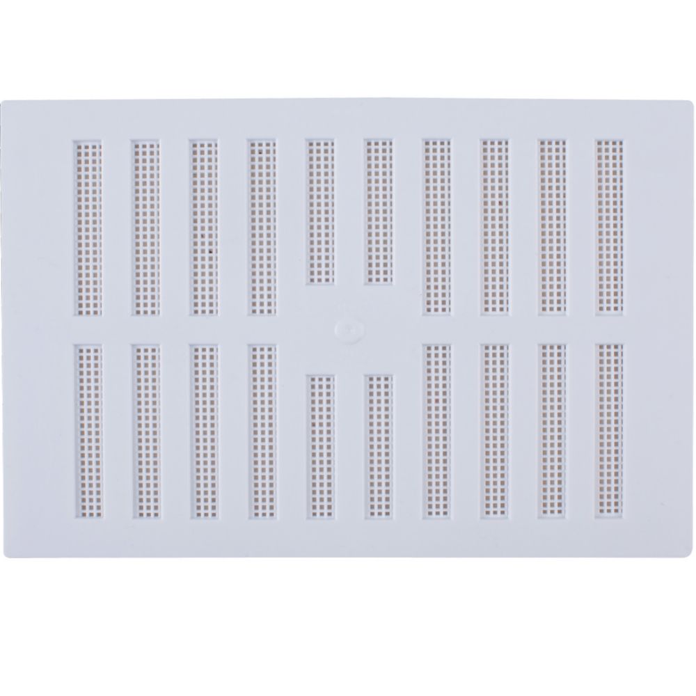

Basically, we live on a hill and my 1930s semi-detached house's elevation is around 650ft above sea level so it is very cold. Our home's ground floor is extremely cold. I have found the reason is because we have lots of external vents with lots of gushing wind. There are a total of 8 vents running around the house and they look similar to this:-
Some are to ventilate the suspended floors and kitchen and 2 are there to ventilate an old coal cellar.
Now I know that I must not block these vents as it can cause damp and rot and I don't plan to.
But my question is that can I replace the standard stone/concrete vents with an adjustable/open-close vent similar to this? :-
ae235
Please correct me if I'm wrong, but my reason is simple. Most houses of 1930s have similar old stone vents, but it seems like when these houses were built, the builders didn't take into consideration the elevation of the property where there is a lot more wind/air circulation and had these stone vents with large holes. I'm thinking that so long as some air is circulating, I can put on the adjustable air vents, but closing them slightly during winter period to have smaller holes and for the air circulation to slow down. This should still allow enough draught without being so windy and cold.

you are fitting closable vents so you can close them.
If your ground floor is cold and draughty underneath, that's correct. If it is cold and draughty above the floor, it suggests you have either got holes in the floor, or have no carpets and the wind is coming up between the boards. You can insulate between the joists for a better solution.
Thanks JohnD. Actually to be honest, the floor isn't that cold as it's fully carpeted in every room. The only exception is the hallway which is directly above the cellar. I plan to insulation the cellar ceiling with rock wool to counter this draught.
However wherever these vents are located, the external wall is extremely cold. So please correct me if I'm wrong, but my suspicion is that because my house is located on a hill, fast winds are entering these vents and travelling up the cavity, thus cooling down the walls a lot more than one would normally expect.
I actually had a company out to insulate the cavity to resolve this, but it's been denied because their survey revealed that there is rubble within the cavity and also some of the stones are almost bridging the cavity, so unfortunately I can't go down this route. This is why I'm thinking it should be okay to reduce the speed without causing serious damage. Of course as soon as winter is over, I'll open all vents again during the warmer weather.

the hole through the wall should not be open to the cavity, it should be sleeved. If you have access under the floor, you might be able to find or make a sleeve. Sometimes slates were used, mortared into the wall. You can also use loft insulation wood, poked into the gap tightly enough that it will not come loose and fall out. Rake out any of the rubble that you can reach first.
I have had some success with a powerful builder's canister vac, poking the suction hose along the bottom of the cavity. It is easier if you can take out a brick at each corner.
Prefab rectangular sleeves probably exist, but I have not seen them on sale.
Your right....I now remember when one of the vents was taken out a while ago, it was totally sealed around it. So now I'm left in a bit of a pickle, because all this time I thought that air is escaping from the gaps in the vent/cavity and cooling parts of the wall down, so what could it be?
Even if I could vacuum the rubble from the cavity, what do I do about the stones/bricks bridging the cavities?
just get out as much as you can.
If air is not blowing into the cavity from the airbrick, it could be blowing up, for example, holes where the timbers of a porch or bay window are built into the wall, or a doorframe, or maybe just bad pointing or bricklaying. With luck they might be accessible under the floorboards, and you can inject expanding foam round the joist ends which might also reduce squeaking. I had a house once with such big gaps over a bay window that the cat climbed in when I took the floor up and wouldn't come out. I had to push an inspection lamp in for her to see how to escape.
I think your spot-on with regarding to air coming through the bay-window, because I can feel it through the wooden sill. I'm sure there is no way of accessing this without either taking brickwork out or ripping up the sill to fill the cavity.
