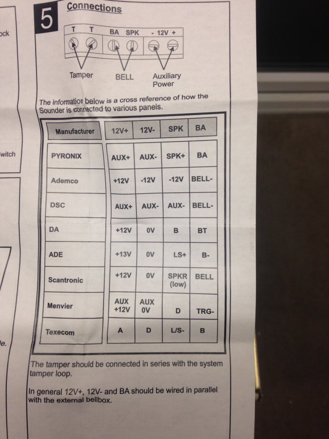

@sparkymarka have you used this yourself and also where will this connect into the Texecom panel? I currently have an alarm cable coming from the panel to the point in the wall where I would like this dual device: Plays the siren nd beeps too.
Thanks @Europlex.
Have you used this personally? I have a single alarm cable between this device and the control panel. Is this adequate and which port on the Texecom panel should I wire this into?
