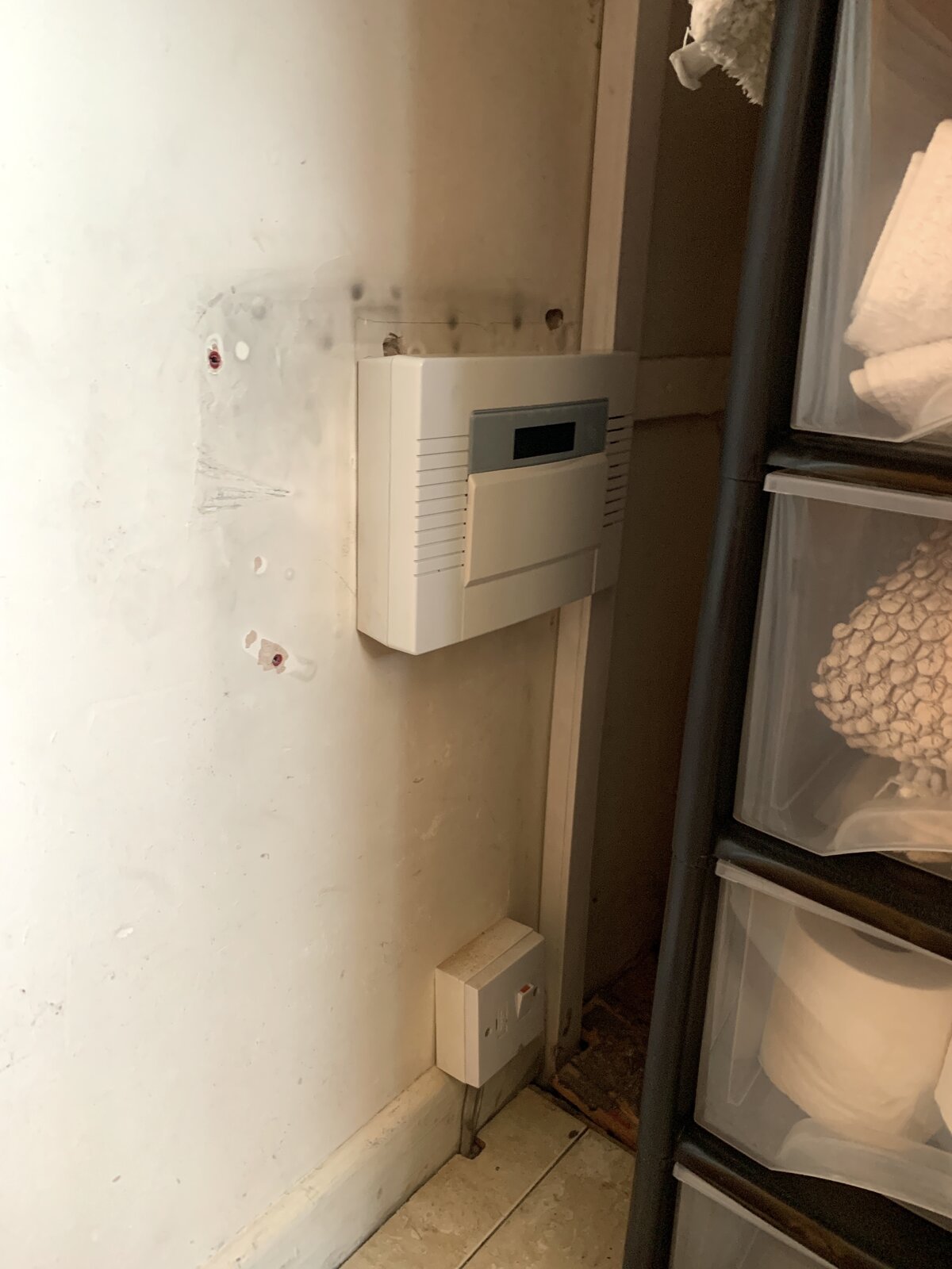

Hi all,
Looking for some advice on location for a pyronix enforcer alarm panel. I want to be able to wire it to a deltabell lightbox.
Is it simply have it installed in the attic as I can’t see me being able to wire it down to the hallway area?
thank you in advance!
If there is no easy cable run for a wired bell, I have seen enforcers being installed in the loft before.
consider the user though, can they set it remotely?, are they using fobs?, if there’s a problem with the system will they be able to hear and read the panel...
Is there an airing cupboard or something similar on the landing that you could fit it to make it a bit more accessible and still have an easier cable run for the bell?.
If you place it away from the entry route you may want to consider an arming station.
I've got my panel in the airing cupboard upstairs and an arming station by the door and all seems to work well and main panel is easy to get to.

Airing cupboards are not ideal for the batteries in the panel ( if it’s a warm cupboard with hot water tank )
"airing cupboard", you are joking aren't you?
NEVER put a control panel OR an extra power supply in an airing cupboard, you will never stop replacing batteries the heat is too much for them.
When the cupboard is over loaded and the 'boxes' are getting covered up problems with cooked batteries is always accelerated.
Of course, if you don't mind being woken up at silly o'clock it won't be a problem.

Hi
Here's how its installed in the cupboard, same place as the pro installed Stirling 10 I just took out.
Now you've mentioned about heat and the batteries, my genuine question is, What about bell box batteries when its south facing, the last bell box was up for about 9 years and never had a battery change and was still going strong?

The external bellbox battery is not subjected to constant high temperatures outside !
