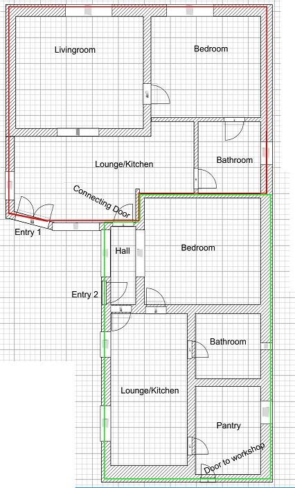

I am looking into an alarm system to put into an old house over the next few months (The property is in Slovakia)
We are looking for an unmonitored system which will put granny's mind at rest, being all alone at home and vulnerable etc (You know how it is!)
The house is a "bungalow" as such as that all the living spaces are on one floor.
It is divided into two different sections. Red will be house part A and Green house part B.
Granny will be staying in part B (Green)
We would like to be able to arm both parts of the house individually, so when the person living in part A goes away, it can be locked down.
Visa versa, if person in A is there and granny goes away, she can arm her side.
If either wants to go into the other part to pick up something or whatever, they should be able to go via the hallway and disarm part A from within the house and easily.
She is currently 74 years old, and the idea of her memorising codes to get into the house isn't so good, so perhaps a proximity keyfob which she can hover in front of a panel with a simple system of holding it there for a longer time to do various things.
For example flash fob in front of panel for a sec (At entry 2 inside hallway where she enters the house) disarms and arms her side, holding it there for 2 seconds arms and disarms whole house, indicated by LED's or a tone or something.
Same for the other side of the house, person should be able to arm the WHOLE house and the separate zones. Also a keypad backup in case fobs run out/fail/get lost.
Is there a system that can do this type of thing?

I was looking at the Honeywell ADE variations which seem to go for peanuts relatively, here in Slovakia they have a habit of overcharging for products by about 150 - 200% of the UK going rate, exclusive of labour, hence the DIY approach.
Just chasing walls for cables and stuff at the moment, renovating the house step by step, but it's getting there and I want to make sure all the existing conduit is inside the walls to install the alarm at some point without having to knock half the house to bits again later.

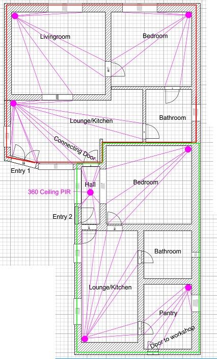

Just had a play in Photoshop...
Bathroom windows will be so small it will be almost impossible to get in, and about 2.5M off the ground outside.
Plus I *think* there is a regulation against having LV items in a bathroom here, unless they have the appropriate IP rating, from what I can see there is nothing specific for bathrooms, but someone in the trade like yourself might know more about that subject.
What would you fit there anyway, PIR with heat/steam might give false readings, Microwave (I believe) messes up with steam as well.
So you'd need something to detect window breakage, and window being opened. Being Double glaze units at 2.5M off the ground of 90X60cm I wish them good luck, in any case they can't steal anything from the bathroom bar a bar of soap and some toothbrushes, the PIR would detect them as soon as they came into the rest of the house.
Do you know if the Ceiling mounted 360 deg PIR's can see almost directly below them, or do they have a blind spot? It's a rather tricky hallway since its very narrow, has 3 doors and 2 windows.

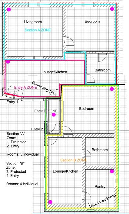

And again, Areas A and B
4 different zones.
Intermediate for A and B and Entry for A and B.
I'd love it if the alarm panel would show which sensor is triggered and give a name for it, example "Bedroom 2 triggered 06/04/2012 06:22AM".
Instead of "Zone X triggered."
When you read a product and it says 8 zones, does that mean a maximum of 8 devices for end of line connection? (If you want to give each device in each room throughout the house a separate call sign)

premier 48 2 prox keypads one in each area eg house A grannyflat B. contacts on both sets of doors and interconnecting door contacts on both sides, set keypads to local keypads, example grannie comes in her door exit tones start swipe fob on keypad turns her area off only, wants something from main house goes through interconnecting door swipes fob turns off house and so on.
i'll second that.
the accenta range would be good for this purpose, but the premier excels it since you can have areas.
Sparky has hinted at what I was suggesting.
Although not ideal, it is a work around with multiple door contacts, although there is one you can use if still available with two reeds in one housing.
But the gist is the same and you will need at minimum two keypads but 4 would be the best. No ways of errors then, with each allocated to an area.
You could use just two keypads and have the "walk through" zones as appropriate.
Its just easier with 4.
But all is possible here.
