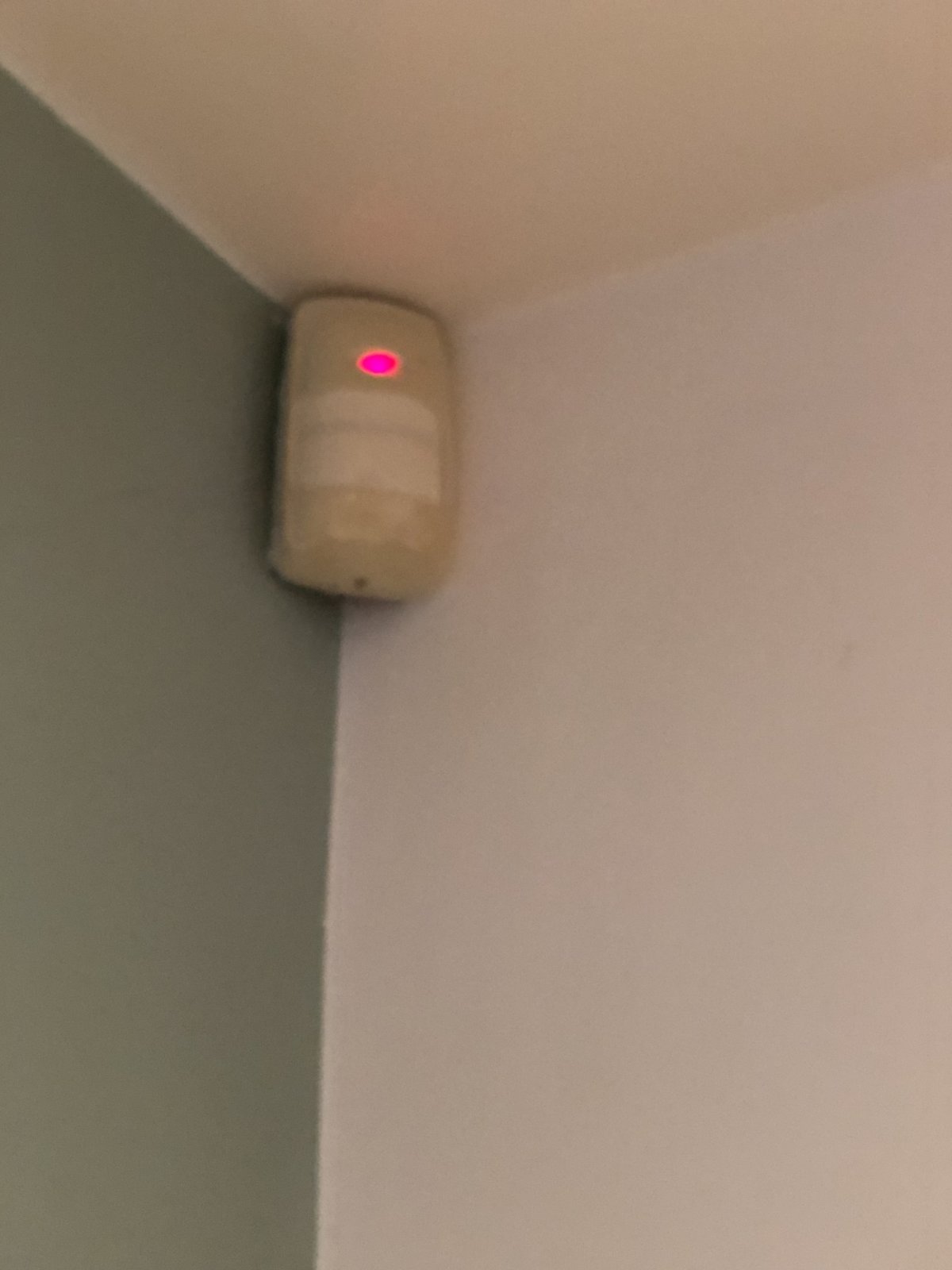

I just checked the log and it's telling me zone 5 which is the lounge PIR. I've just noticed that the zone 6 kitchen pir is a bit hit and miss too.
If it's slow ...then it's less likely to false alarm ...post picture of detector
Visonic k980 ....rubbish they go slow with age ...replace with Bosch pet detector depending on ...A you have a pet ....B what it is ?
Two miniature schnauzers. Thanks for your help, advice taken onboard. I presume that's the cause of the alarm and fitting new pir is straightforward without engineer code ?
