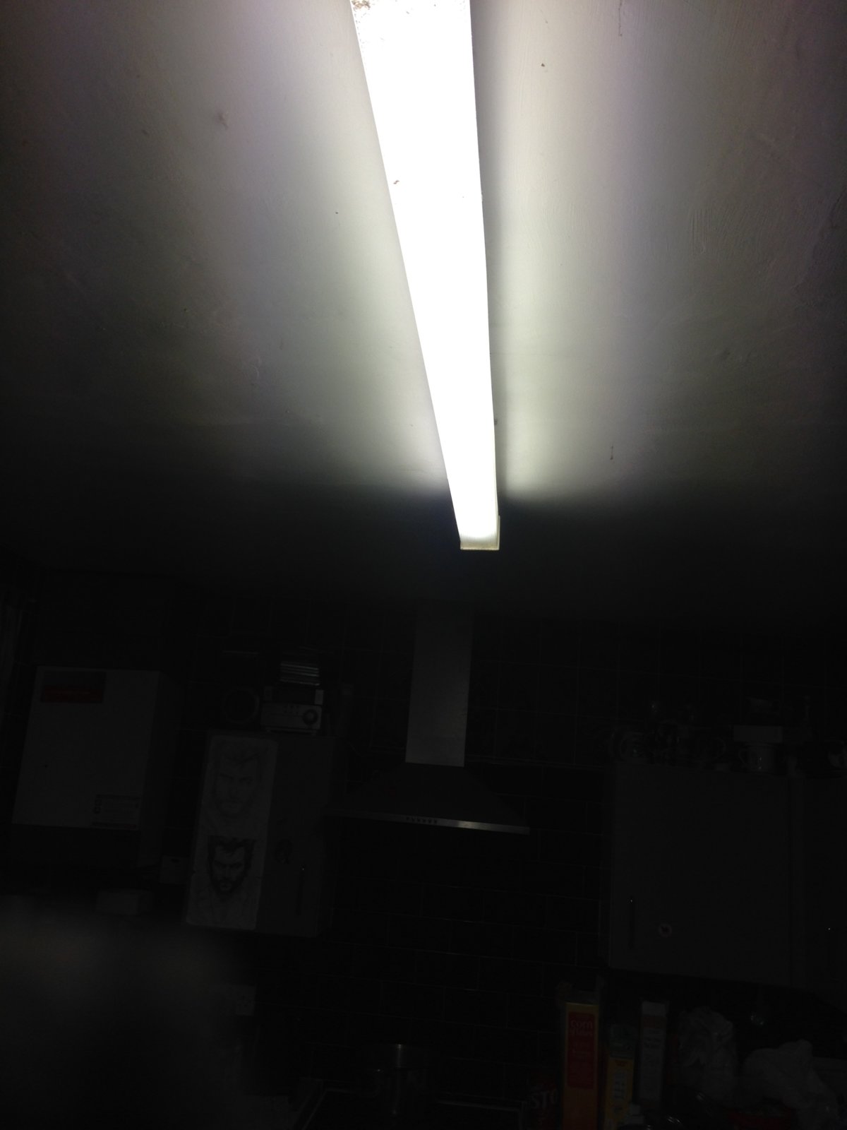

Few months ago not every time but sometimes when I turned off kitchen light it set off the panic button on alarm system . So I disconnected panic button but now when I turn on or off light the cctv monitor goes black then comes back on anyone got any ideas thanks
Long tube light but also think lamp is doing it too they got energy type bulbs in I changed plug socket to see if that changed anything but no .

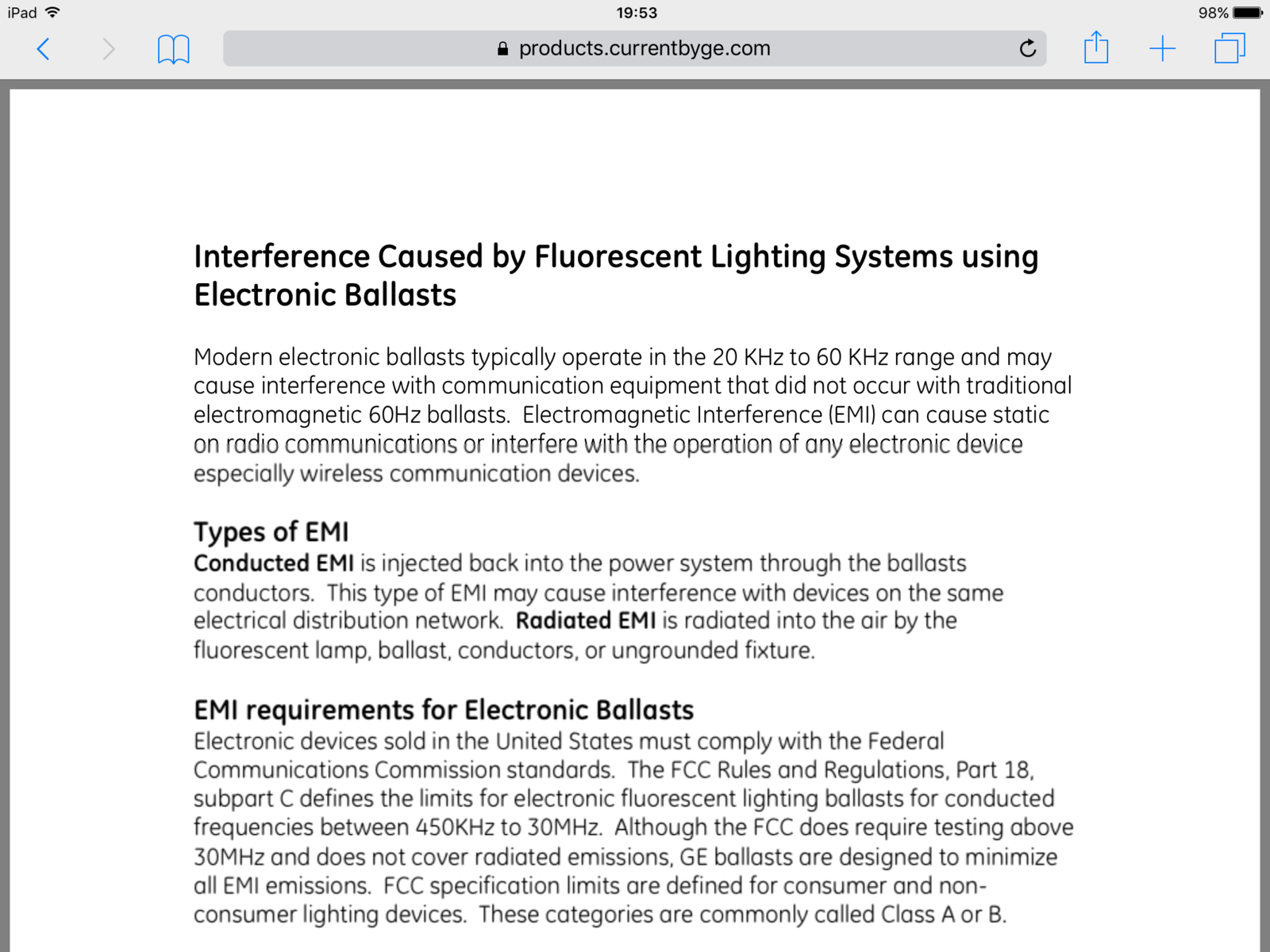

I'd suspect the lightswitch is arcing slightly and should be replaced.
I'd also suspect the alarm and cctv systems do not have interference suppressors in their mains and signal wires.
