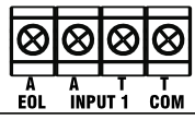

Hi Bianco, I have a Pyronix Euro 46 panel (which I assume is the same as the enforcer) and the inputs connectors are labelled as below. Can you advise what the corresponding input is for the Z33 and Z34 input as per your diagram?

Never mind, got it working.
For those interested, the Euro 46v10 uses the standard input for keyswitch latched operation. All you have to do is connect the NO & Common on the sonoff to the 2 a inputs on the Euro 46 and connect the 2 t inputs to override the tamper. Then in the control panel set the input to keyswitch latched and your input area to be the area you want to set/unset.
