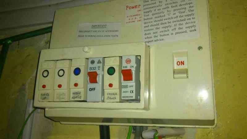

i am attaching a photo showing his current fuseboard if that helps!
looks like he might have an RCD somewhere, or some numpty has just stuck 2 RCD warning labels on there for fun......
is there not space in there to run the kitchen from that too?
Could save him a few £££
