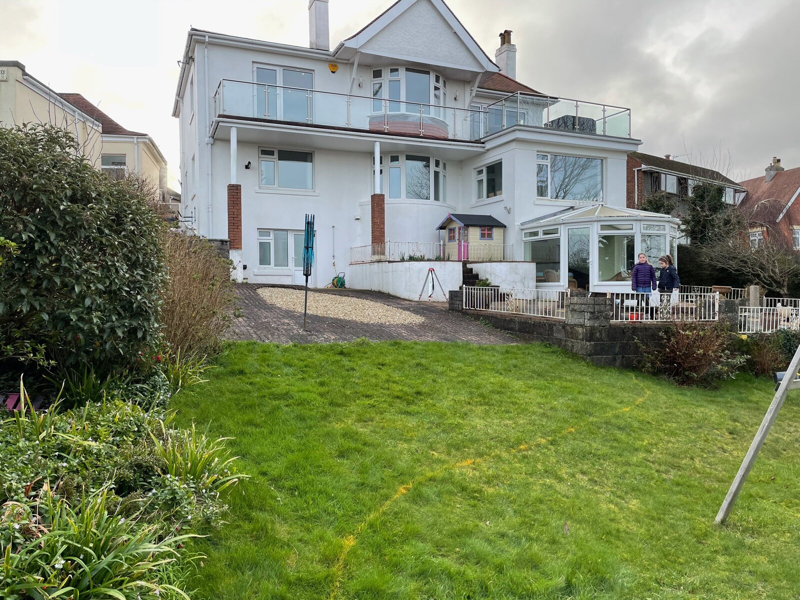

My garden is on a slope. Here is a shot of the rear before we started any work:
We are constructing an in-ground pool in the area where my kids are stood on the right of image. The pool comes to the existing ground level of the terrace they are standing on.

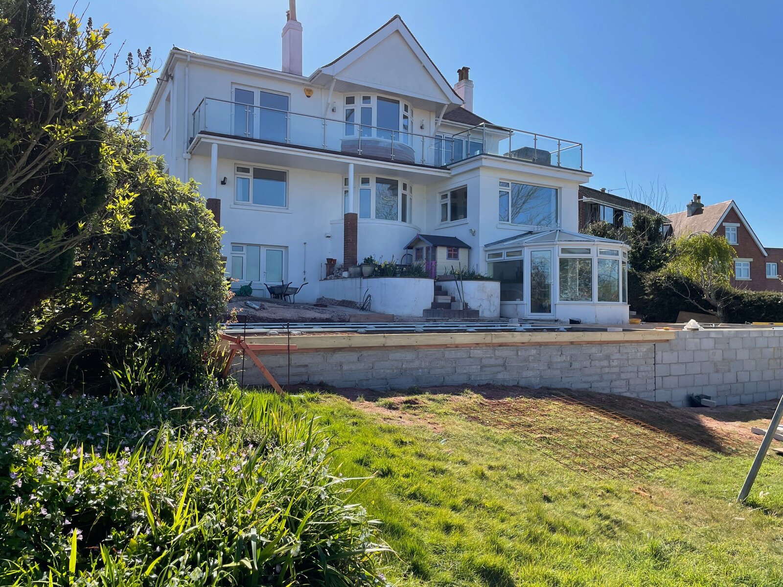

We dug up the sloped patio on the left of image, levelled the ground to be flush with the new pool (the level of the ground outside the conservatory) and built a retaining wall:

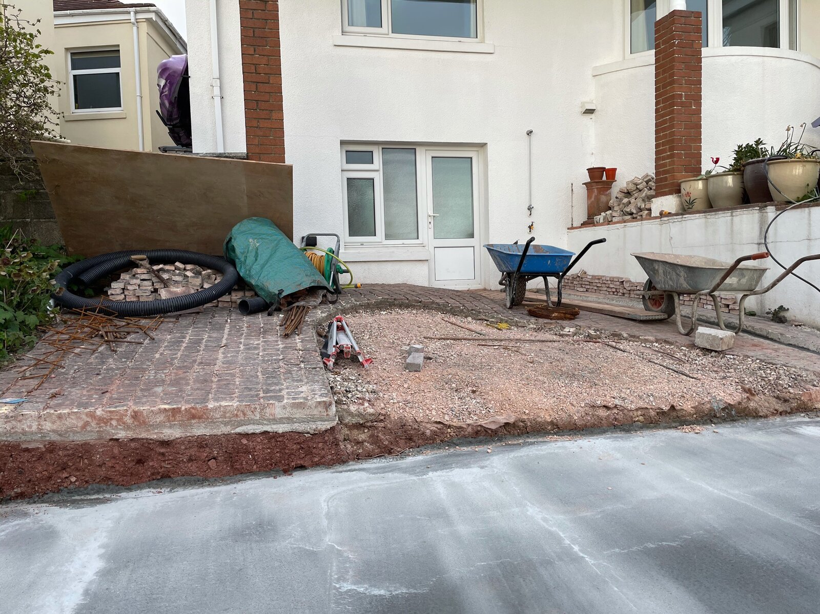

Here's a picture standing at the retaining wall looking back towards the house:
As you can see, this clearly shows that we have dug down about 34 cm from the existing ground level at the house. We've not elevated. You can also see this by looking at the two curved planters in the earlier images.
The retaining wall for the decking is about 55 cm on the left above the earth / grass rising to 1.3 m above the grass on the right. We have obviously excavated down into the garden to construct the retaining wall footing. We will be installing railing.
