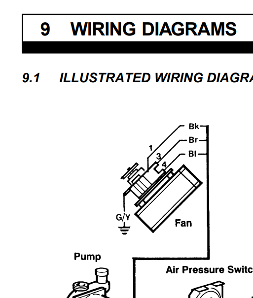

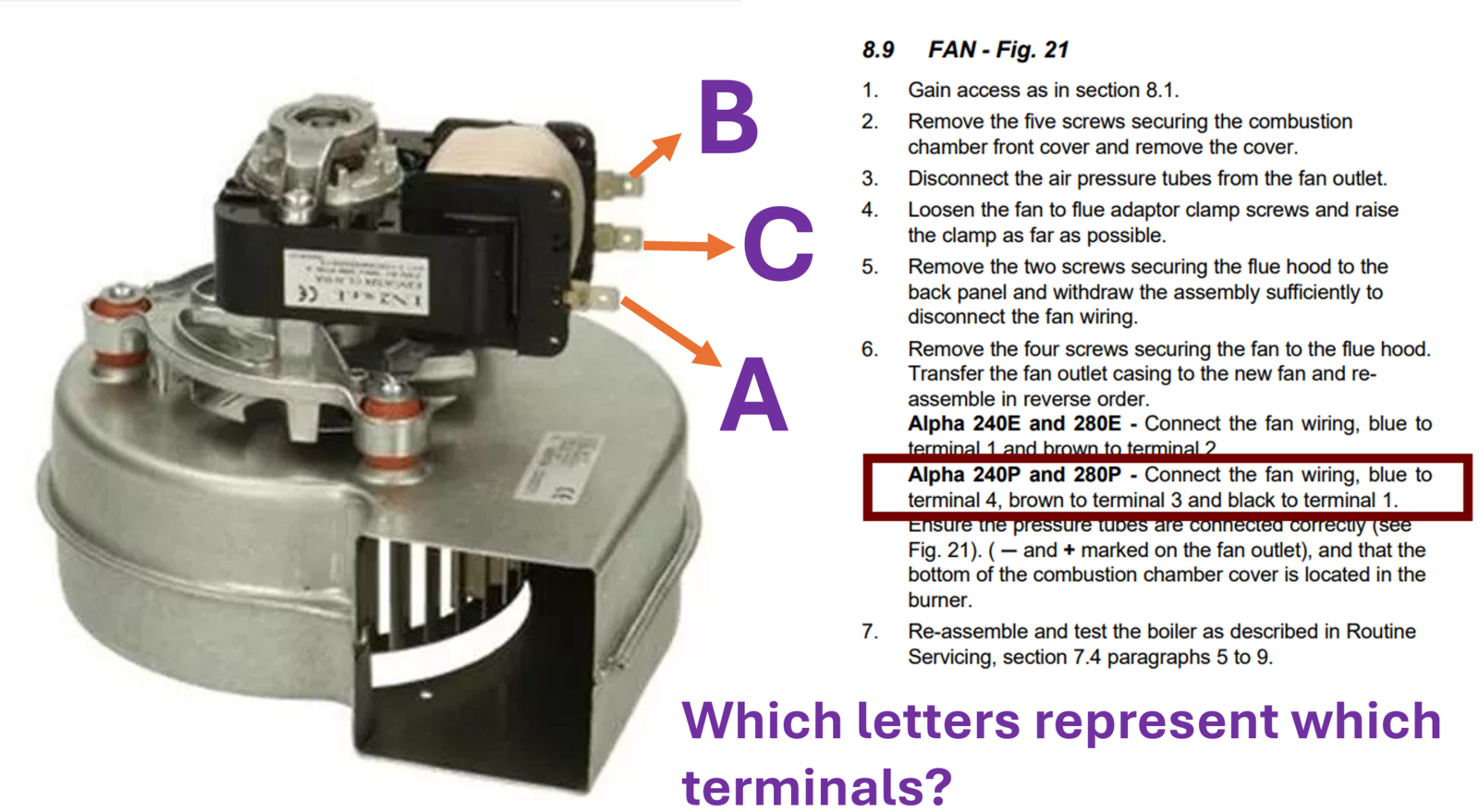

Hi,
Can someone please tell me which tab (A,B,C) relates to which terminal (1,2,3) on the attached diagram?
Many thanks in advance.
