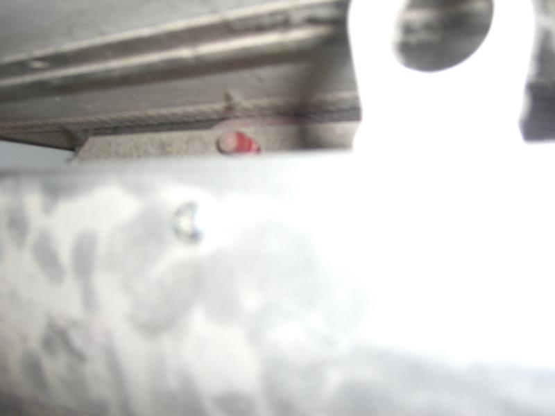

It's behind (not to the left) and 5 inches down from the top of the boiler which is 4 inches from the ceiling; how stupid of me, I naively thought it might be accessible to human beings. It explains why the manual glosses over how to recharge it though.
Is this something that should be checked during servicing? Looking at the dust on it, it's never been touched. (sorry about the poor quality picture)
I can just reach it with the ends of my fingers, but cannot get enough grip to remove the cap. Looks like an external vessel is needed. :(
