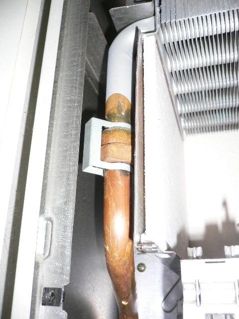

Hi,
I've got an Alpha Ocean 240E with a trickle leak from joint just below the Primary/Main Heat Exchanger. Photo attached
Can anyone tell me if this is a threaded or push fit joint and what type of seal if any is used.
The joint has a retaining clip over.
Many thanks
G
Okay, found out it's a push fit with O ring seals.
Anyone done this before and can give any advice?
Cheers
G
very easy to fix but get a tube of silicon lube, the Regin stuff available from most plumb centres etc is as good as any and smear some on the replacement O ring
Hold on there....
//www.diynot.com/forums/plumbing/diy-gas.8090/
Clearly not understanding such a simple issue as an O ring joint proves incompetence.
Taking the combustion chamber off the fan and heat exchanger out is madness. It is very easy on these models to re-fit certain components and drastically effect the combustion safety.
I can guarantee more than a couple of O rings will be required and although the parts are cheap they are absolutely essential.
Leave well alone and call a boiler engineer.
