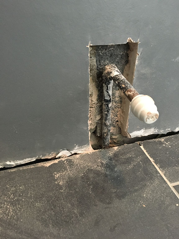

I need to extend some copper pipe in the wall by 30 mm.
It's a tail for a bathroom towel rail. The numpty plumber firm installed one tail 30 mm lower than the other.
I've another plumber coming to look at it on Thursday.
Here's a picture:
The pipe runs under the floor then rises within the wall and pokes out through the plaster.
I've removed the surrounding plaster to expose the pipe. There is some upwards movement and around 2-3 mm gap between the rear of the pipe and the blockwork.
Clearly there is no room for a pipe-slice but I'm hoping that (after draining the heating system) the plumber could cut the pipe using a padsaw with appropriate blade then slip a straight coupling over the end to solder a new piece of copper that exits 30 mm higher than the previous.
I'm hoping to avoid taking up the floor tile and cutting into the plywood subfloor.
What are you thoughts on the issue?
I'm relieved to hear (so far...) that it should be achievable without too much trauma. Hopefully the plumber who comes on Thursday will concur :unsure:

No this is a bonafide cowboy I'm afraid.
Both pipes are limited in their vertical movement by the notched joist that they are resting on and the plywood floor that is screwed to the joist. I can feel it when handling the pipe. There is not 30mm play attributable to that. 10mm absolute max.
I can solder when the mood takes me :p
