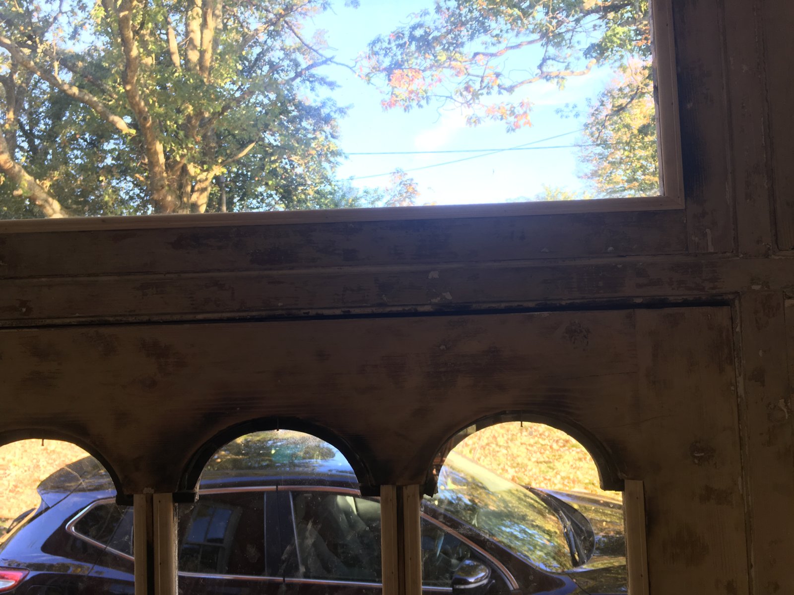

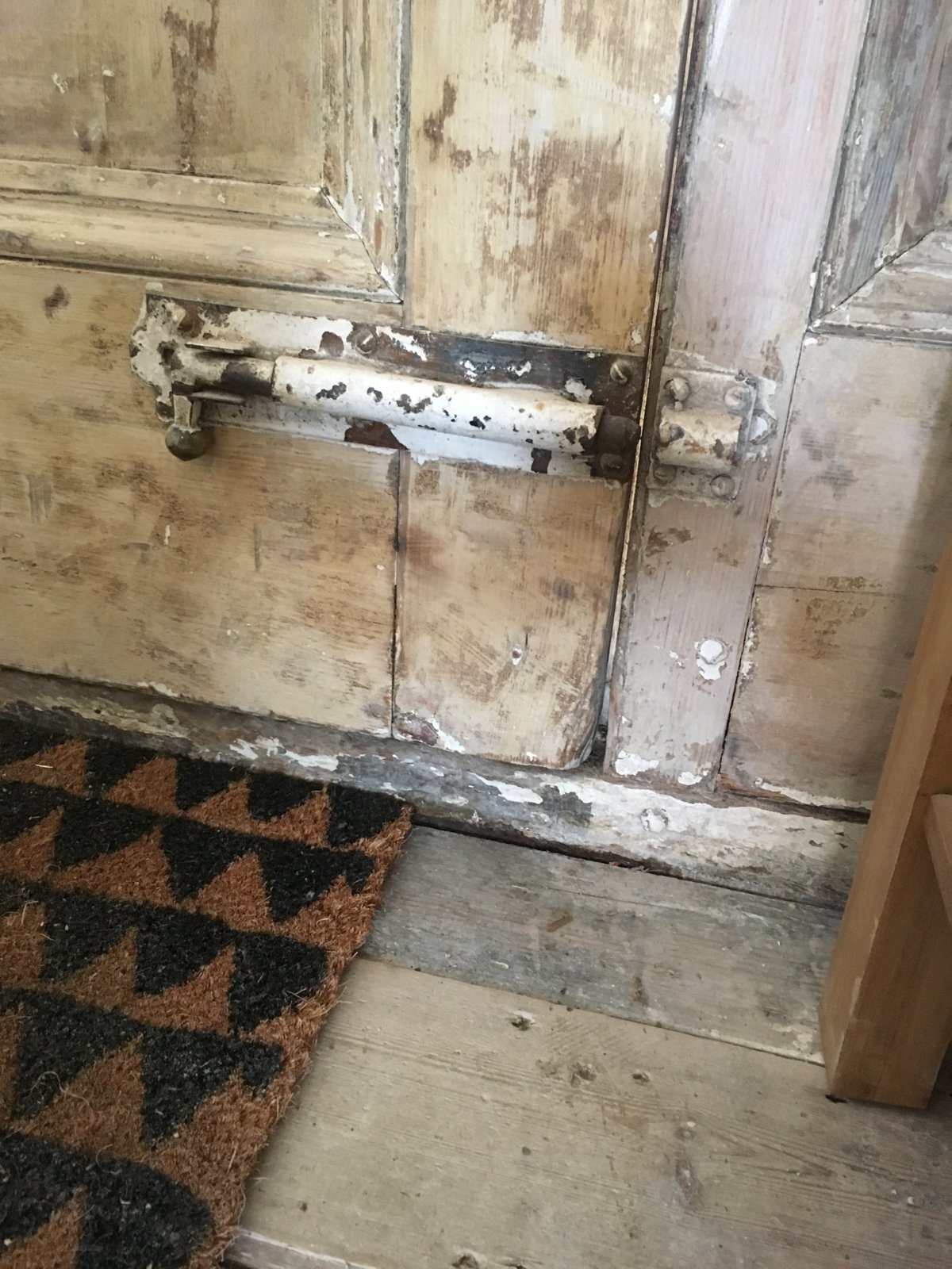

we have a very beautiful Victorian front door that is in overall very good condition, but isn’t fitting tight with the frame at one corner. Having never adjusted a door before I’m reluctant to take out the old hinges until im sure the correct thing to do, but need to sort it out as it’s very draughty. The door fits perfectly along the top and hinge side all the way from top to bottom, but at the handle side is slightly sticking out at the bottom corner to about 50cm up. Somehow I need to pull the bottom corner in. The hinges are old but very sturdy and not lose at all- I can’t tighten any screws. There is a slight wedge shaped gap at the top corner of the same side but it is fitting tight and not letting in air there. Do I need to pull out the top hinge or pull in the bottom. Or something else? Thanks

You need to check if door is warped , twisted or simply misaligned .
Sometimes a book fold weather strip will seal , easy fix and easier than foam strips which only work if the door is in line .
This is really difficult to diagnose - ultimately there are far too many things to consider, see foxholes comment above.
You can either apply random packing techniques with various foams as a diy temp fix and hope for the best. Not pretty and will likely be ineffective.
What you need to do is remove the door and check for warping, twisting, moisture absorption on the door itself. Temp and humidity changes have a big impact but it this can be lessened by the door having an adequate finish (varnish, paint, wax etc) to keep it more stable and reduce this effect. The current condition and location of the issue lends me to believe swelling and movement from moisture.
From outside, with the door closed,can you see that it sits flat against the door stop (door jamb)? Depending how it sits may be able to give you a best guess of what’s happening before you start trying anything.
