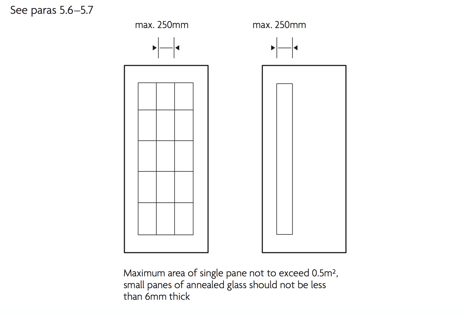

I have internal doors which are about 40 years old,, each fitted with 10 tulip pattern glass panels 12" square. There is no removable beading to get the glass out.

Approved Document K
5.6 In the context of this approved document, a ‘small pane’ is an isolated pane or one of a number of panes held in glazing bars, traditional leaded lights or copper lights (see Diagram 5.3)
5.7 Small panes should be provided in accordance with all of the following.
  1. In a small annealed glass pane, use glass with a minimum 6mm nominal thickness except in the situation described in b.
  2. In traditional leaded or copper lights, when fire resistance is not important, you may use 4mm glass.
  3. Use the dimensions and areas shown in Diagram 5.3.
Basically panes less than 0.5m2 in area do not need to be safety glass as in toughened or laminated BUT have to be at least 6mm thick to give it strength from its thickness
There is if your getting someone in like a joiner or glazier to do the work, they have to abide by regs (above), however if you were to do the work yourself then as I also said above no one is going to come and check your glazing meets regs.
Not quite true. If the glass width exceeds 250mm , regardless of the m2 , it has to be a safety glass ( or most doors wouldn't actually require safety glass ), under 250mm it has to be at least 6mm thick glass
