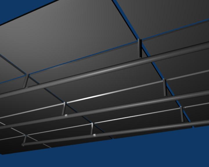

ok, call me crazy, but i want to try this
i want to construct a wet room but a slope is not posible
how about this for a mad idea.
instead of one waste, have many small ones placed where the 4 corners of the tiles meet. like in the picture.
i can acces the floor from underneat via the kitchen roof to fit all the little pipes and conect them to the larger pipes
also, i will sink the grout in a few mm so the gaps between the tiles act as little trenches so the water flows to the holes.
any thoughts.
dont laugh, i am adveturous :D [/img]
So, where do you intend to put a trap which you could, if push come to shove, service?
Think you'd save yourself a lot of heartache if you just bought a wet room tray - these have slopes inbuilt.
