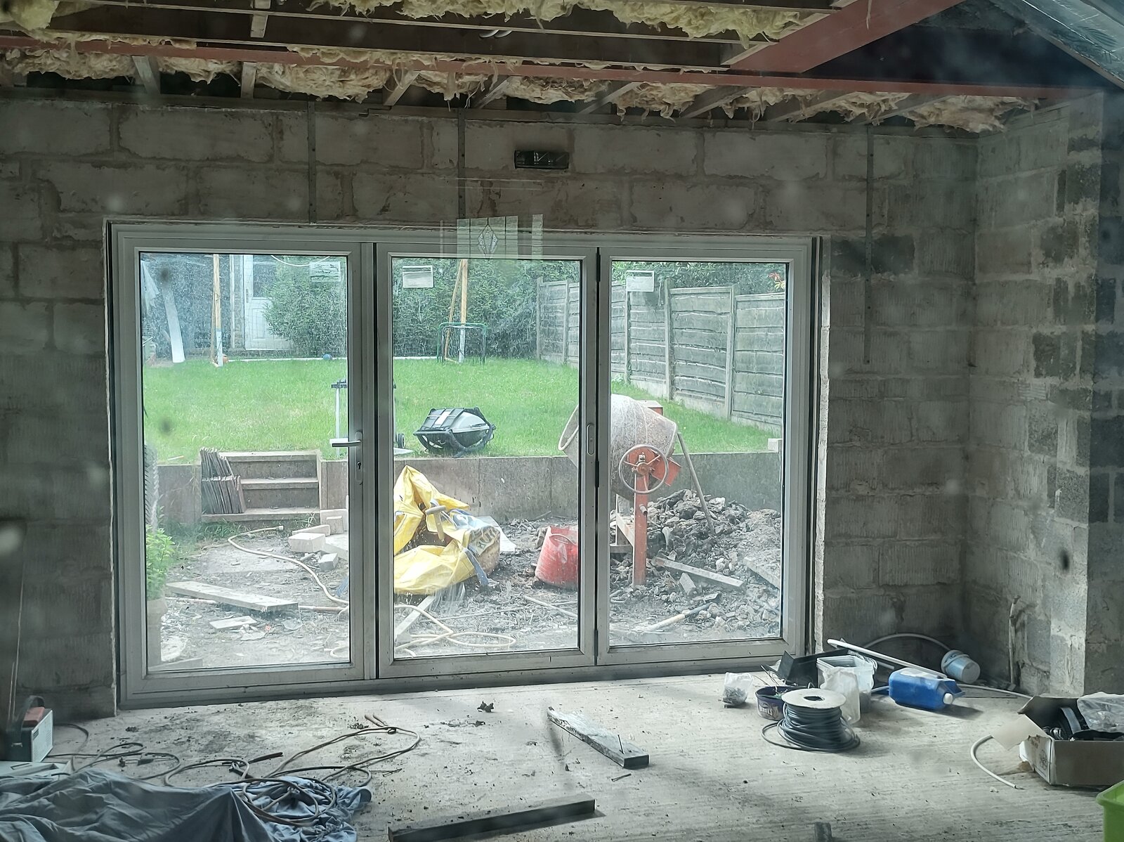

I've helped a mate install a bi-fold and the one he had got, was OK, but over time I can see issues with sagging etc.
He bought it second hand... made me wonder if the original owner had had issues with it.
My slider is engineered wood with an alloy outer skin, triple glazed.
Not the cheapest, but top quality and it's a please sliding it open and closed... lovely bearing sound... I know sad!
Also I think when you factor in all the frames for each leaf, you are losing a bit more light.
I would possibly go for sliders, however - my bifolds are (there's probably a proper name for it) one fixed door and two folding panels - which means the bifold bit will get very little use/wear and tear given British weather. I think they'll be a bit more expensive than the standard panel ones.
