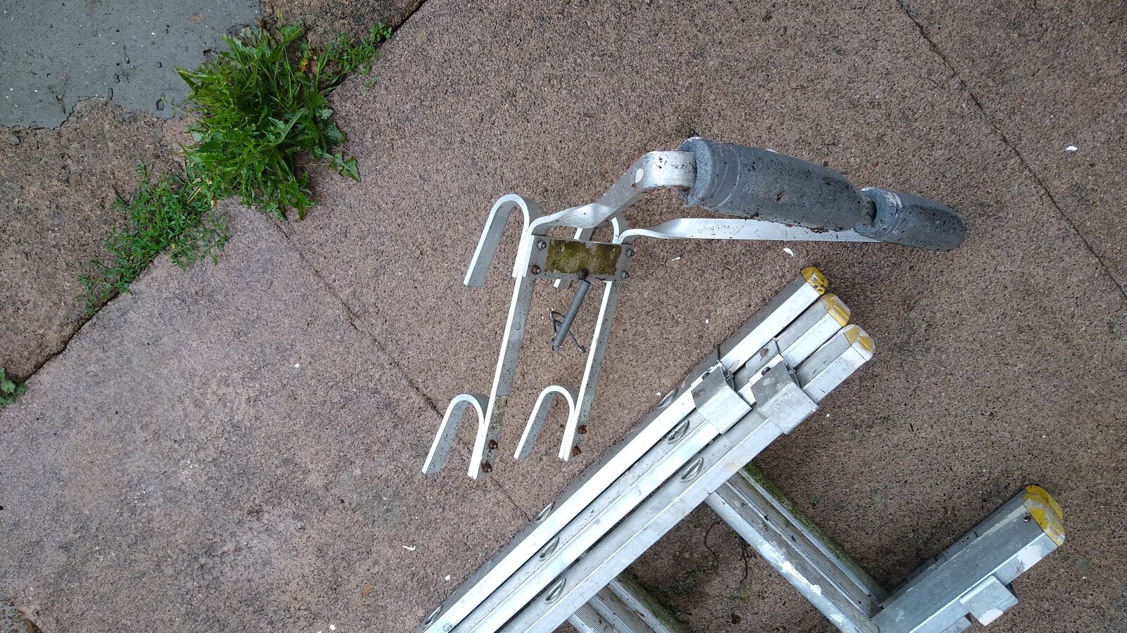

Well done. Now get yourself a 'Stand Off' - you will never regret buying that ladder accessory. Makes it much safer and easier to work at height. I modded mine to make a plywood tray to stand tools and paint pots on. Adds little in the way of extra weight.
I'll post a picture later.
I cover the standoff contact area with 22mm pipe lagging, its much kinder on fresh paint when second coating and grips better than the factory rubber strip on, shouldn't say this but unavoidable sometimes, glass.
