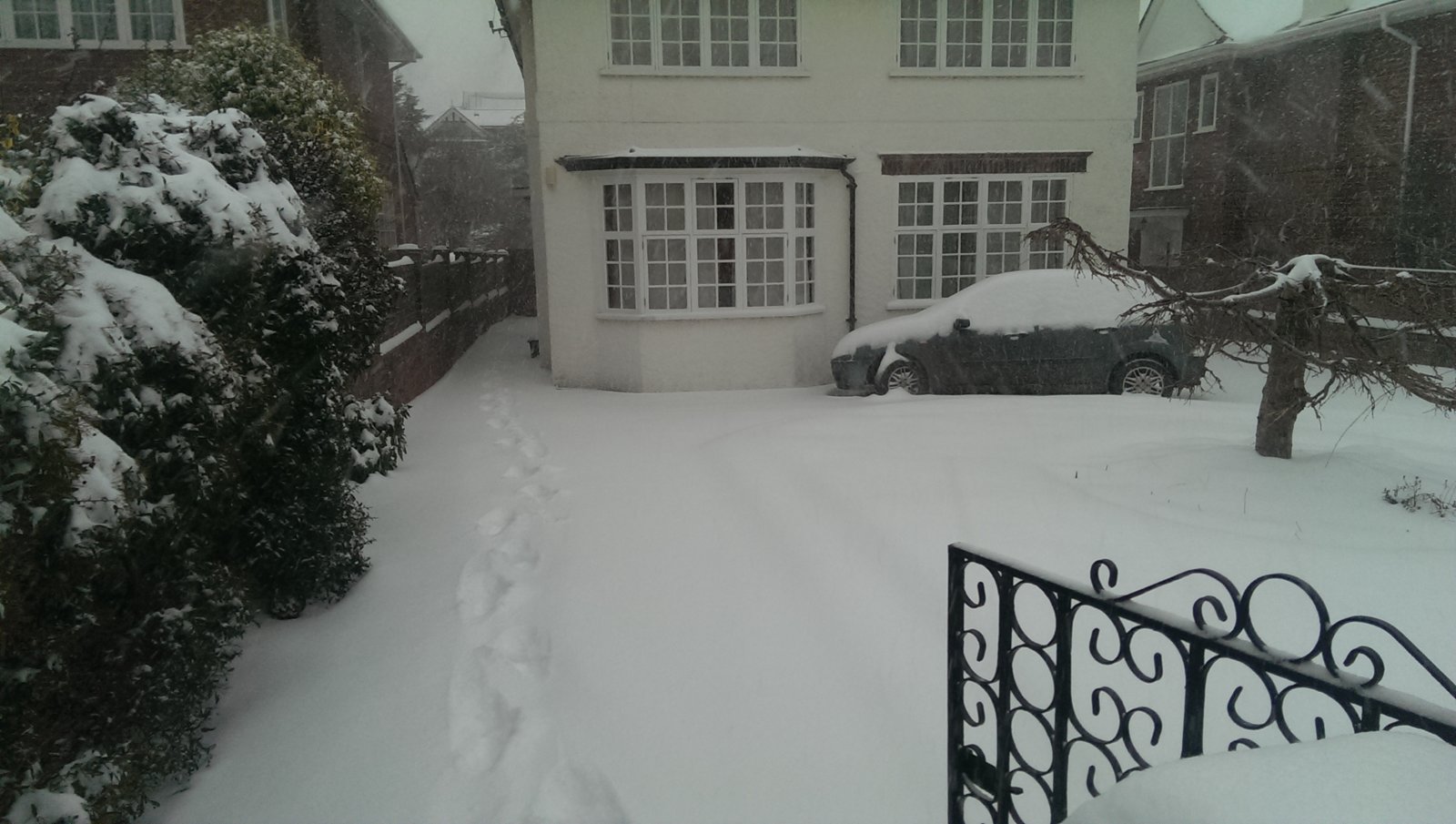

Our worry with Residence 9 is that the frame width outside is 100mm whereas the existing wooden windows are 75mm.
Picture of existing windows attached.
I wonder if this would reduce the 'individual' pane size by too much so as to make the windows look unattractive.

To be honest you have some nice large windows there so I don't think you would even really notice the odd 20mm here and there. Also bare in mind a little bit of the timber frames are behind the render so true frame sizes are probably pretty close to R9.
The corners on the bays I expect are where R9 will be a bit more chunky as you will have 2 frames plus a corner post, Rather than 2 timber frames cut on an angle and butted up.

I dont think you would get many options on the astragal bar for aluminium windows. Are you talking about the depth of the r9 from front to back being 100mm?
Thanks for the helpful information.
R9 depth front to back is 100mm I believe.
The existing Windows are 95mm.
We do want to avoid any internal trims to make up any gaps.
We are a few miles outside Exeter.
If you did go with a standard 70mm deep frame the window could be fitted to the inside plaster reveal with the outsides rendered in.
Looks like you have quite shallow external reveals so would improve weather proofing.
