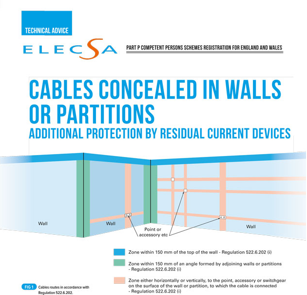

In 2004 with Part P the game started to change, with installation certificates, but domestic has always been lacking in paperwork. Hence why we have permitted routes, the placing of sockets and switches should tell us where the wires run, but today the smart phone with camera has changed what is being done, now common for people to take pictures, in the main in case they forget where the run.

As @big-all , cables 'should' run in 'prescribed zones'...

on domestic works you might be over thinking it. Provided you had a good electrician doing the work and assuming he followed all ”safe location” rules any future electrician will easily be able to work out the circuit design.
it would be no problem extending the ring into the conservatory, an electrician will be able to work out the existing ring by visual inspection and testing
It’s not often people need to screw into the ceiling so cables won’t be disturbed, in the walls you can work out where cables could be by following safe location rules. If you need to know for sure then unscrew the sockets (with power off at fuse box) and have a look

You must have seen and noted where at least some of the work was done, there will be tell tale signs like replastered chases; if not, inspection of the back boxes will give clues whether the cable run is above or below (likely from above in a kitchen with solid floor), finally if you have sockets in the wall against the proposed conservatory, a sparkie will have no problems in extending the ring. So stop pestering the company or offer to pay for their time.
