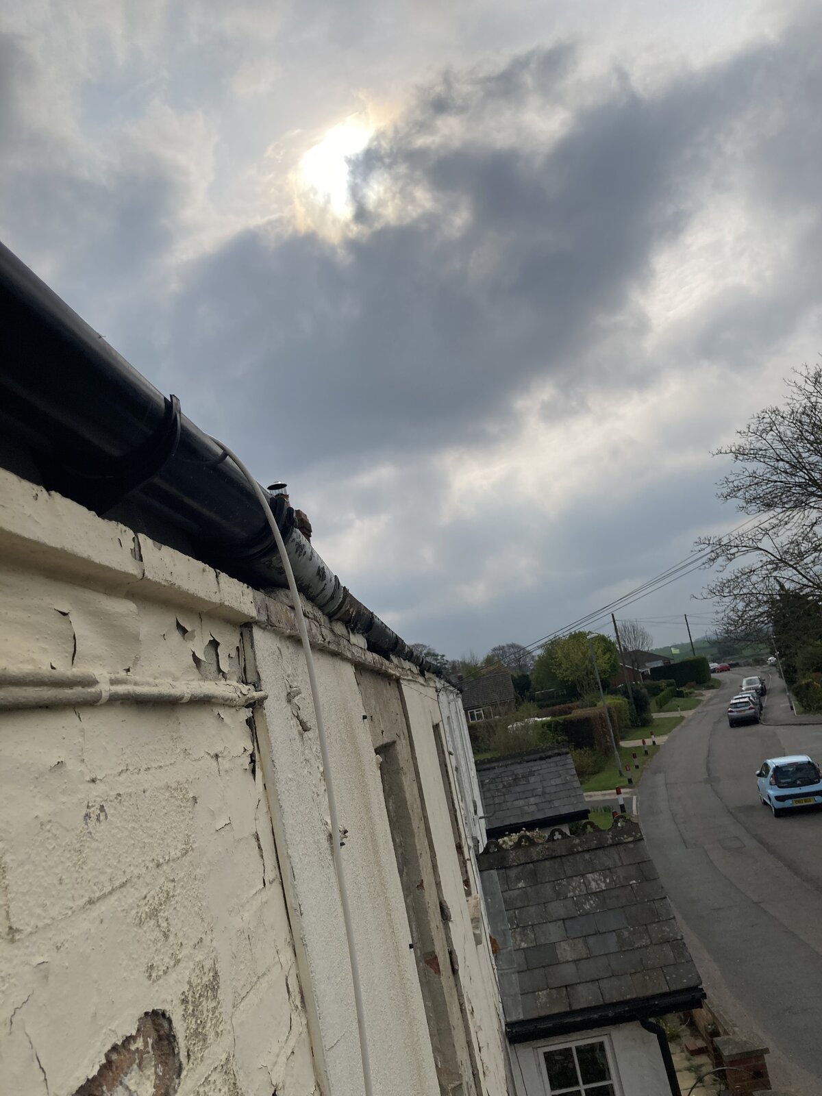

A a few pics would help - from a distance showing both houses would be helpful.
and if you could say what gutter you had installed and what it replaced, would be helpful.

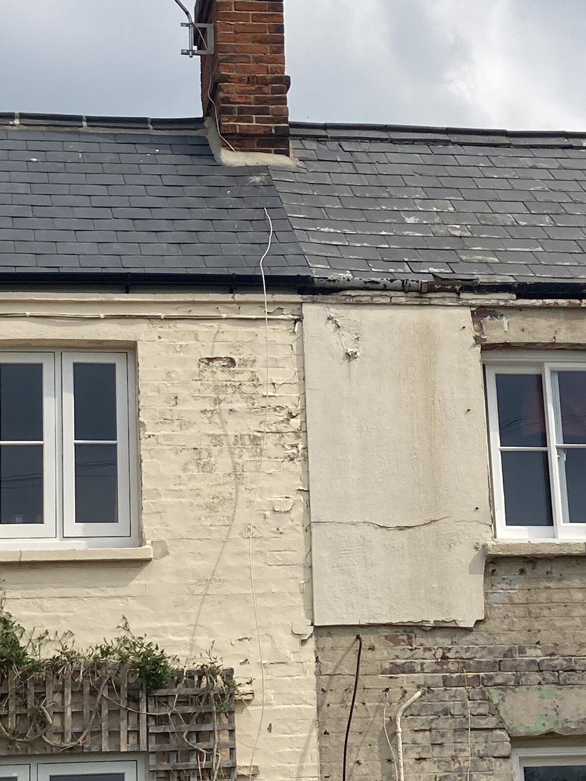

Attached are some photos; our house is on the left.
I think there is a combination of problems, or which the hump is just one, but I would be interested to see what you think after looking at the photos. My personal feeling is that the gutters have been leaking for some time, but not noticeably, since the jutting brick ledge just below is causing it to disperse elsewhere.
the gutter on our side is upvc. The gutter we replaced was plastic too in places, but some cast iron- it has been repaired in the past by the looks of it. The neighbour’s gutter is all cast iron except for a foot or so of plastic, just across the boundary- the join between our houses is therefore plastic.

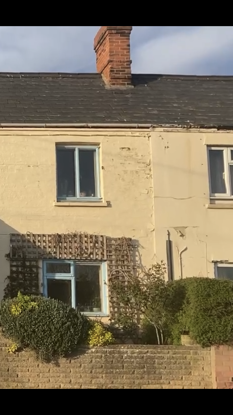

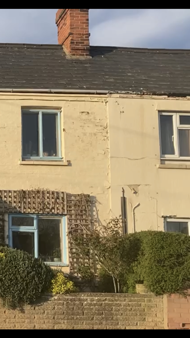

I’ve also uploaded a photo of the original guttering and roof before we replaced them. Sorry the quality is crap- it’s a still from a video.

Think the problem is at the joint. Also it looks like something is supporting the guttering at the joint and more concerning is the raised slate. Water could be getting underneath the raised slate and tracking along the wall plate.
To be honest I think your neighbour has the more problems - they are either ignorant of or that if they're aware they are hoping you will resolved at no cost to them.
I agree with wgt52. That tile poking up is definitely an issue and has been for a while because it f the staining to their wall . Also can I ask if you know what is fitted under the tiles where they have been cut to meet each other ?
This needs further investigation, roof and gutter.
the haunching around chimney looks wrong, I’m not a roofer but that’s normally weathered using lead flashings
the neighbours tiles near the chimney and are damaged and could be leaking
there’s the poking up tile others have pointed out
there is some strange markings on the remaining render and a short bit of gutter replaced above - there’s a chance there used to be a downpipes there. I wonder how many downpipes there are in the run of cottages - I would suggest standing back and see if you think the spacing is as it should be

How is the junction between the old roof on your neighbours and the new roof on yours done? There dosen't appear to be any continuation of the slates across the join. Is there lead (or Aluminimum or copper) under the slates on both sides of the old and new roofs to cover the break in the bond?

Your new roof install is a lazy, incompetent bit of work.
1. Your new slate roof installation is wrong - it could have been "matched" with the slate roof covering of your neighbour. Eliminating the need for a conspicuous join, the slates could have flowed across the party wall - but it would have required more work.
2. The roof join is humped suggesting that however it was bonded below the roof cover it was done wrong. The hidden tile battens will be cocked up.
3. A Bonding Gutter with an upstand could have been used?
4. Perhaps a lead strip has been used?
5. Whatever, the proud join is likely to leak.
6. The chimney stack mortar fillet is wrong, the stack should have lead flashing.
7. Your neighbour's gutter appears to be leaking on his side at the CI to plastic connector. Damp stains can be seen below on his render. Pics of the gutters from above needed.

Union is leaking to neighbours side. They have a in busted slate on first course and at the top . All will leak.
You have a damaged gutter bracket.
Cables rendered over could also be a way in.
The rendered panel must be hiding something .
Having said that , the original gutter would have been ogee cast iron sat on the string brick course this would have been a much more suited job .

despite having gazed up at this so many times already, I can’t believe I hadn’t noticed their lifted slate- thank you for pointing this out. Of course that will leak; I’ll try to mention it to them when they have calmed down and are willing to hear it. At the moment they’re set on pinning the blame on us and aren’t being reasonable.
