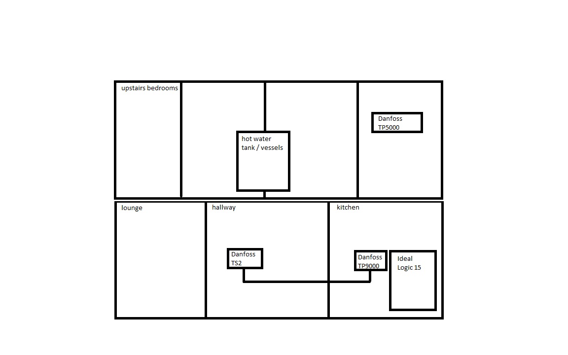

Am I ordering the right TADO products for my Danfoss CH/HW system boiler or am I about to made a big mistake?
7 Aug 2019
9
I've read a few other threads with similar set-ups but am just a tad unsure on whether I'm about to order the right products.
Downstairs zone heating + hot water:
Ideal Logic 15 system boiler with Danfoss TP9000 (wired). Sensor in hall with radiator without TRV.
Upstairs zone heating:
Danfoss TP5000 (battery powered) in bedroom with radiator without TRV
I want to replace it with a TADO system but am unsure as to the products I need.
I think I'll need:
Would this work? Appreciate the help in advance.

The wired version of the thermostat is used by combi's that have a single heating zone. It's wired directly to the boiler and turns it on/off and controls the whole heating system. You have two zones and a stored hot water system. So, it's not for you because: You don't have a combi boiler, and even if you did, turning the boiler off, would turn off both heating zones. Your system will have motorised valves, one for each heating zone, so a single thermostat wired to the boiler would not work for your system.
You are close with your list of parts:
The 'Starter kit with hot water' has a 'Receiver' that replaces the TP9000. But it also comes with a remote thermostat, which will replace the remote sensor in the hallway so you don't need the extra wireless remote sensor as well.
REPLACES TP9000 (Kitchen)
REPLACES TS2 SENSOR (Hallway)
As you figured, the add on smart thermostat can replace the TP5000 upstairs.

Thank you so much for this! Yes I have a motorised hw valve / downstairs valve / upstairs valve. I can now stop procrastinating and get them ordered. Thank you again buddy!
